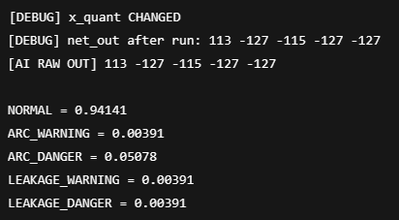

Example output log (repeats every inference):
Despite different input values, the raw int8 output vector is always the same.

4. Observations
  • Input (x_quant) does change every run
  • Output buffer is overwritten (not stale / not 0x5A pattern)
  • Yet the output vector is numerically identical every inference
  • This happens even when sensor values change slightly (frequency deltas, etc.)

HI @seokjs,
Could you try to add a dcache_invalidate_by_addr(net_out, out_len); before the inference:
    /* 1) 입력 복사 */
    memcpy(net_in, x_quant, in_len);
    dcache_clean_by_addr(net_in, in_len);
    /* 2) NPU Run */
    Run_Epoch();
    /* 3) 출력 invalidate 후 읽기 */
Doing the invalidate after the epoch run is a good thing, but we wonder if inside the Run_epoch, the CPU could possibly still look at the cache that is not invalidated. Adding this invalidate could help.
Let me know if this helps.
