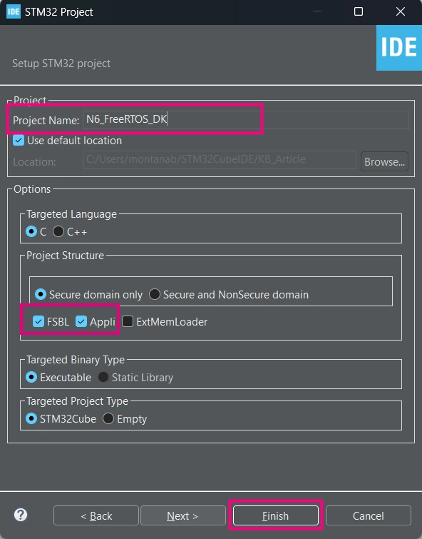

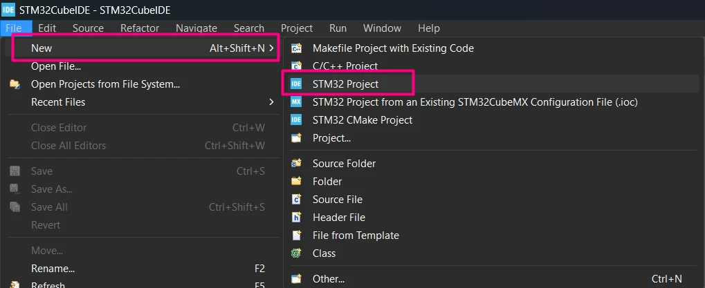

2.1. Start the project
Open STM32CubeIDE and create a new STM32 project.
Start by creating a new project using STM32CubeMX and select [STM32N657X0H3Q]. Select the option to use [Secure domain only]. Select [FSBL] and [Appli].

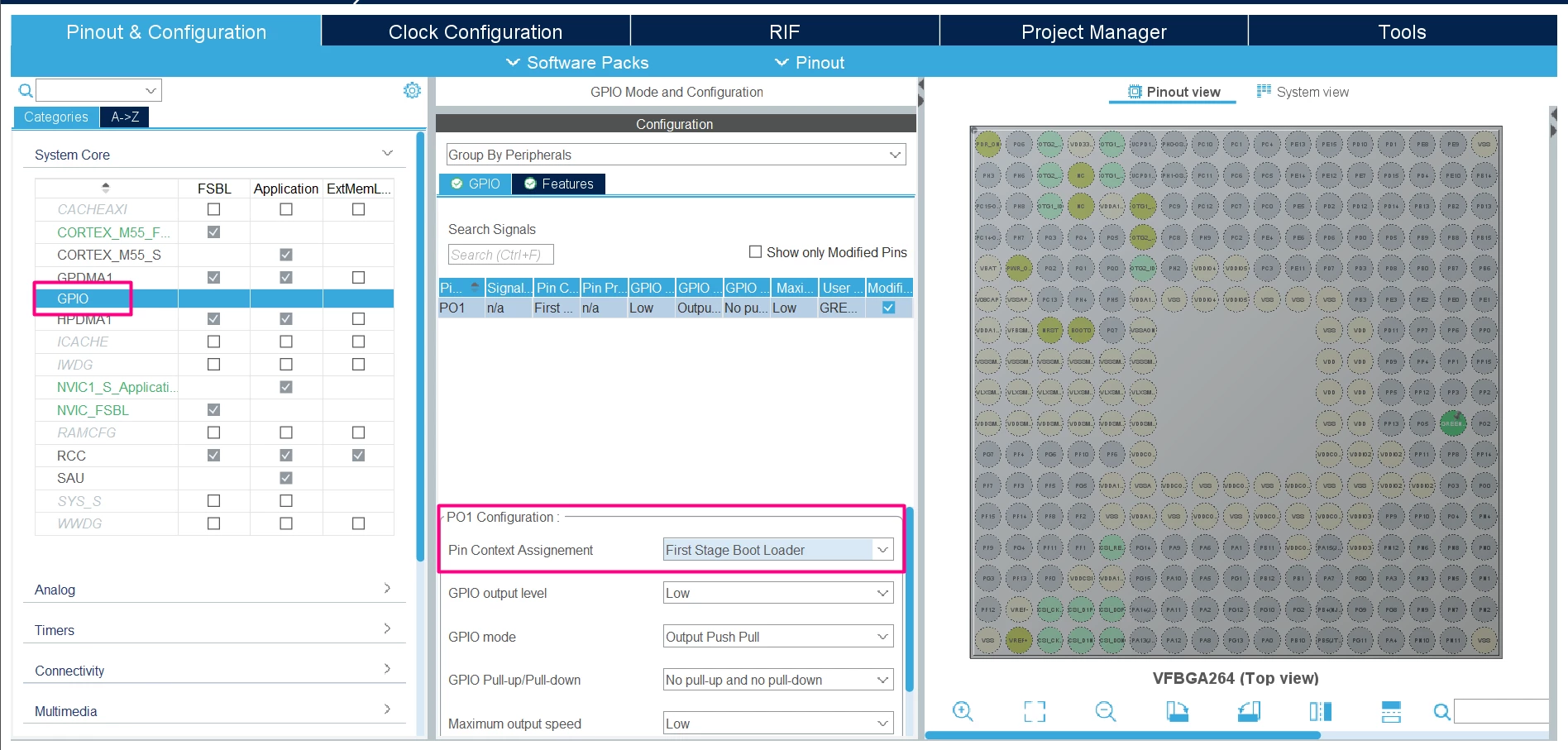

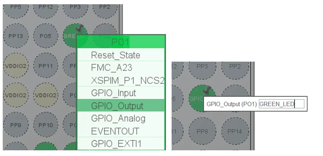

2.2 Configure the LED pins for the application
Locate PO1, configure it as GPIO_Output, and label it as GREEN_LED.
We need to assign the GPIO to be used by the FSBL.

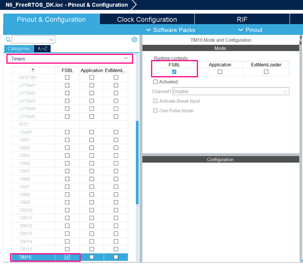

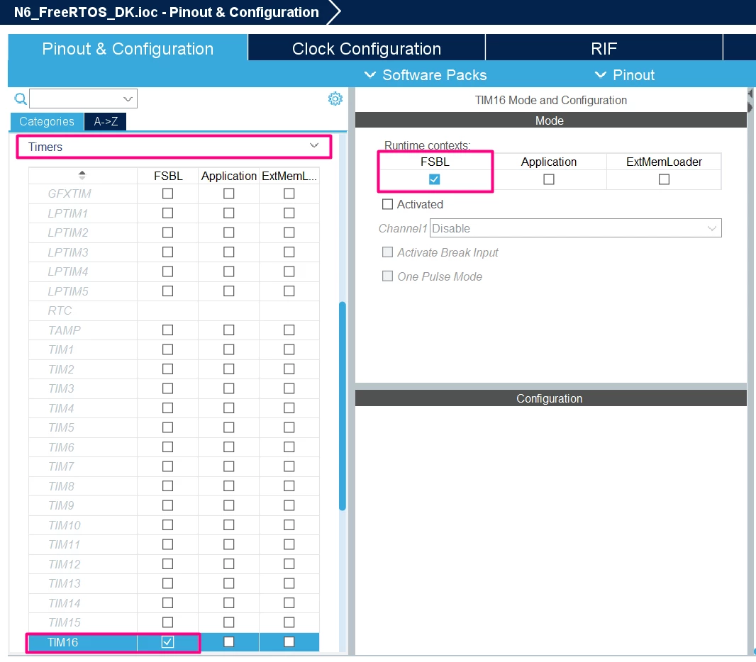

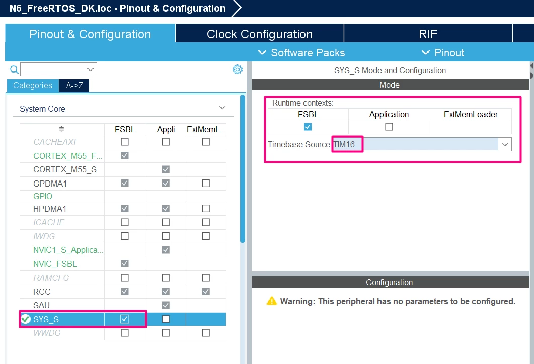

2.3 Configure the SYS timer
Assign a TIMER for the SYS time base, as the SysTick is used by the FreeRTOS™ kernel. This article uses TIM16, but any free TIMER can be selected.

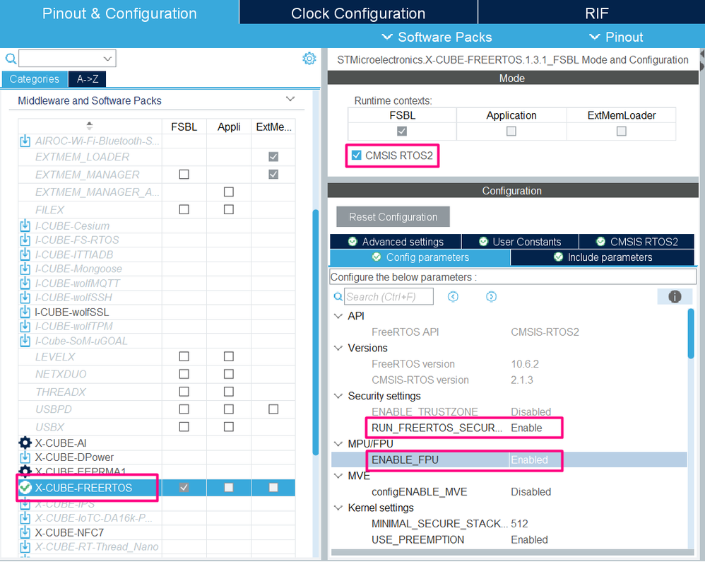

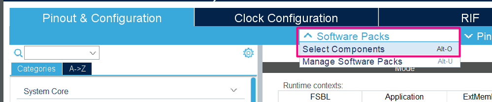

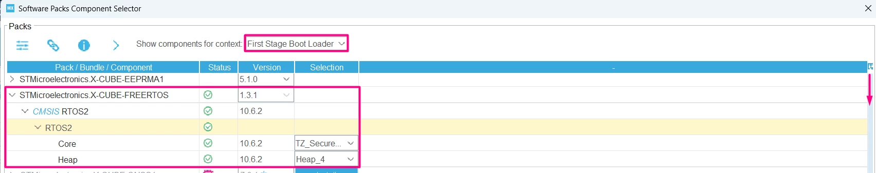

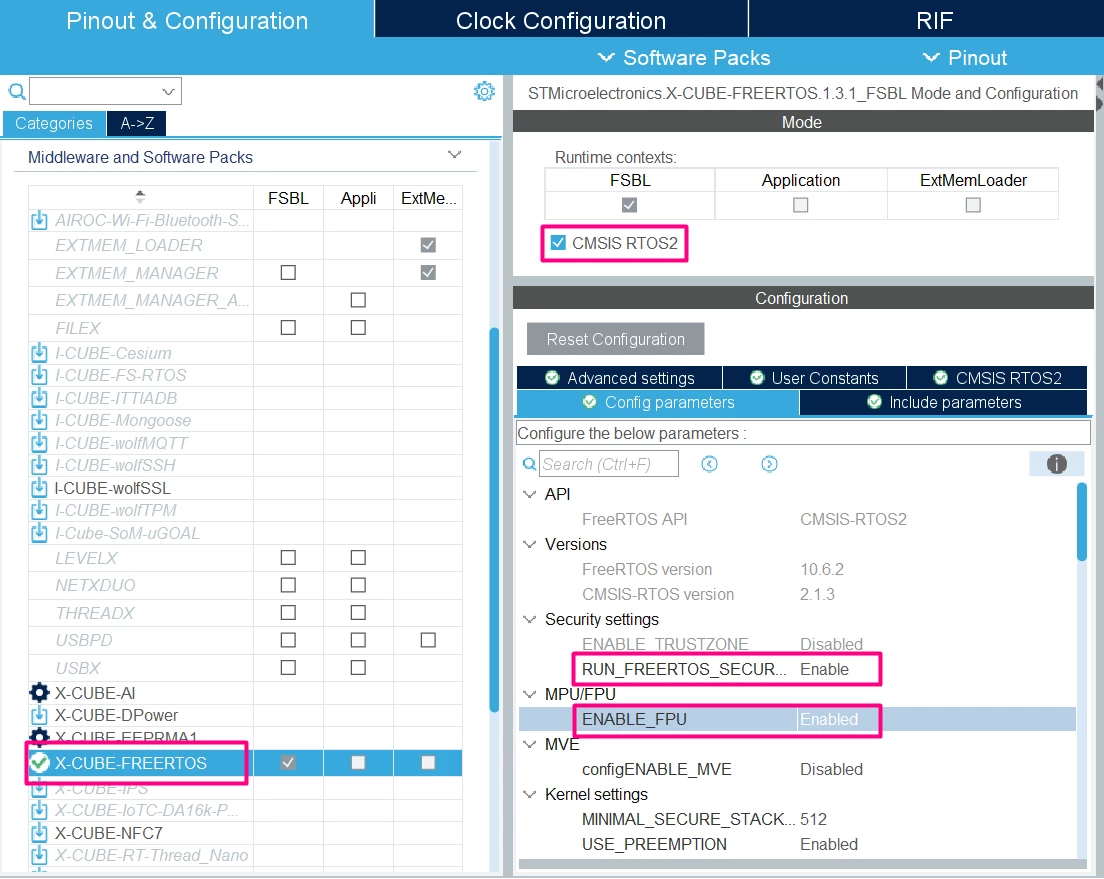

2.4 Add X-CUBE-FREERTOS
Click on "Software Packs" and choose [Select Components] and use the latest version of X-CUBE-FREERTOS
Once selected, the package is added to the "Middleware and Software Packs" categories.
Select the [CMSIS RTOS2] and enable the security settings to use security and FPU in the "Config parameters" tab:

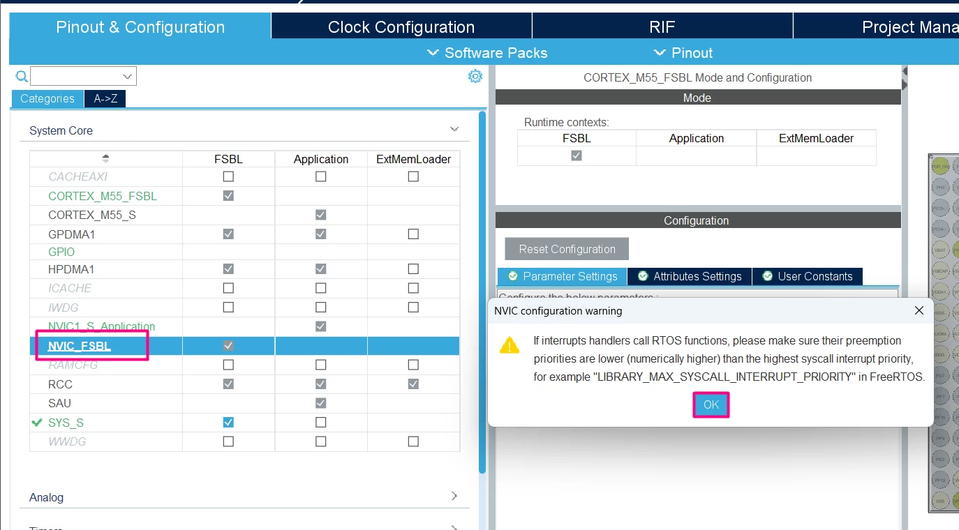

Go to the NVIC_FSBL to ensure that the interrupt priorities are updated, so that the RTOS can manage them:

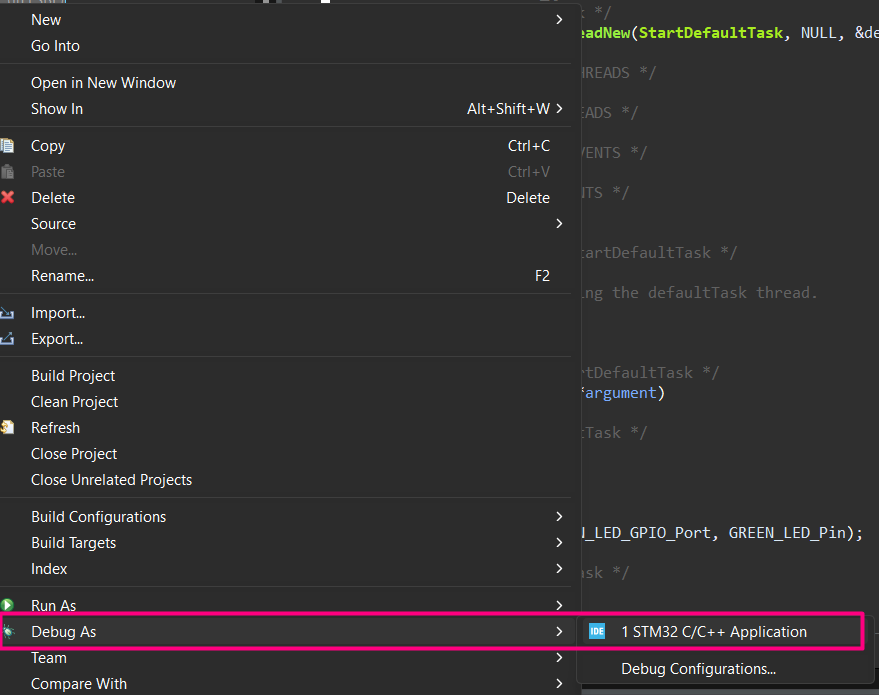

3. Build and test

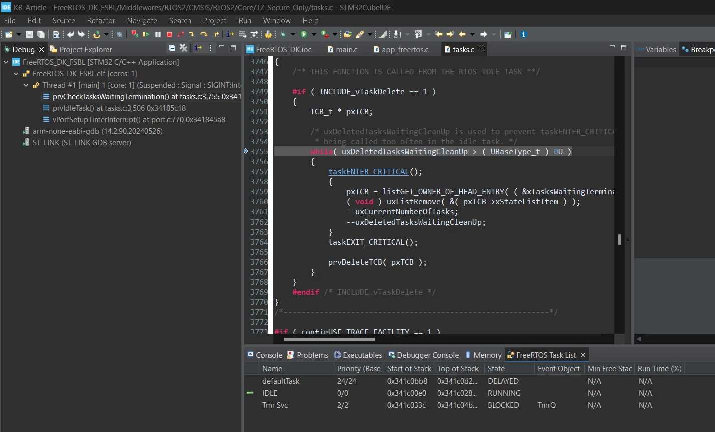

Ensure that the board is in DEV boot mode and enter debug mode:

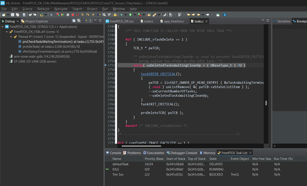

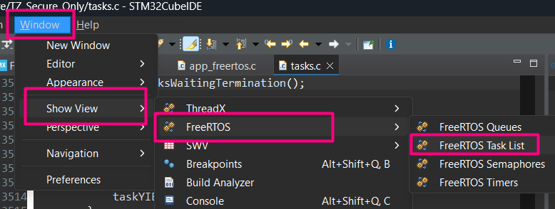

The same debug features are available, which means it is possible to use the FreeRTOS view list, such as [FreeRTOS Task List]:
By pausing the debug, the list updates, allowing us to see the states of defaultTask and IDLE tasks:

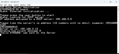

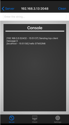

I've made a quick demo (temporarily in a very old repo I have, this will be moved to the hotspot once the articles are completed), running on the FSBL that uses FreeRTOS and LWIP to create a simple server/client application. It is using DHCP and you can configure the server's IP via the UART/VCOM terminal. As this was a simple demo, you'll have to type the IP with the 0s and no ".", for example: 192168001123. The main.h has the TCP SERVER PORT it expects to connect to, the default is 2048. If all goes well, you should see something like this on the terminal
And like this on your server, I've used an app called "TCPConsole" available on App Store, but any server could be used:
