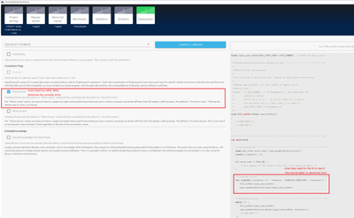

Based on the tutorials, I am trying to create an AI lib using NanoEdgeAI.
The lib seems created successfully, see attachment.

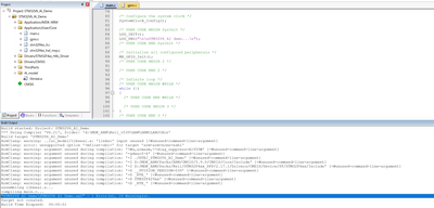

But when I add it to the MDK project and compiler it, some errors like below is present:
When I remove the libneai.a, the project can be compiler normally.
Could you tell me what I was wrong?

It is said we need change the name ".a" to ".lib" for MDK compiler.
And we must check the "fshort-wchar" option for MDK-ARM to compiler and linker successful.

Hello Junde,
How do you link the library ?
It looks like there is a typo in your linker, I can see in your log arm-arm-none-eabi
Have a nice day

To correctly link a static library in your project, you can follow this topic :
https://community.st.com/t5/stm32-mcus/how-to-add-external-libraries-in-keil-mdk-arm-an-example-using-x/ta-p/646624
And documentation from your IDE.
