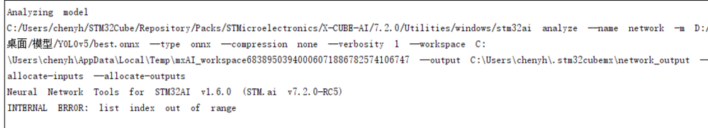

How can I fix the internet error 'list index out of range' when I use xcubeai to analyse a .onnx model? Thanks!
CYunh.1
0693W00000UnhQ5QAJ.pngI trained a yolov5 model and export it to .onnx model. Then use xcubeai to analyse it. But I get an error 'list index out of range'. What should I do?

can you share the onnx model please so we can see if the problem still exists with the latest version and with your file.

The problem still exist with X-Cube-AI 7.3, we are still investigating.

We have identified the root cause of the issue, the model contains a 5D initializer that is not fully supported by our importer yet.
