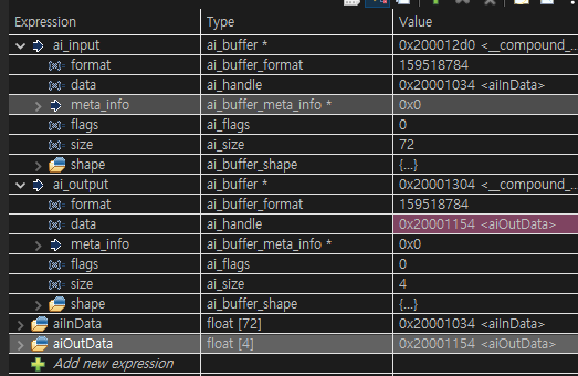

I have checked the 'ai_input' and 'ai_output' values and they all pointed well.

Yes, I increased the stack size from 0x800 to 0x8000.
I am using the Nucleo-L476RG board now,

I checked again the WiKi example which is working fine. Can you share your AI_Init function ?
SKim.9
SKim.9Author
Jul 7, 2022 11:13 PM UTC
Okay, Here is my AI_Init and AI_Run function.
I didn't modify any code from the WIKI page.

Jul 19, 2022 7:01 AM UTC
Hello
I have implemented the wiki on a set up as close as yours : Nucleo-L476RG + IKS01A3 with the LSM6DS0 accelerometer
and all run fine without any hardfault ...
by the way, did you try to run the provided model in the wiki (https://github.com/STMicroelectronics/stm32ai/raw/master/AI_resources/HAR/model.h5) ?
best regards
L.
Laurent
Jul 19, 2022 8:33 AM UTC
Also, one question, in your main , do you initialize the AI twice ?
MX_X_CUBE_AI_Init();
AccelInit();
AI_Init();
I think that MX_X_CUBE_AI_Init() is code generated for application template ... but you are using AI_Init() provided by the wiki.
