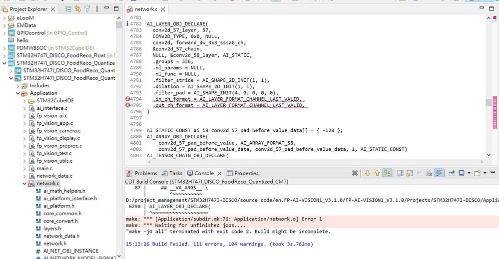

Hi ST professional team
Following the documentation  instructions & opterating
How to use Teachable Machine to create an image classification application on STM32
https://wiki.stmicroelectronics.cn/stm32mcu/wiki/AI:How_to_use_Teachable_Machine_to_create_an_image_classification_application_on_STM32
How to resolve compilation error messages:

Nicolas_V
I did the Wiki again on my side and did not face any issue.
For your case and would verify two steps :
Delete the following files and replace them with the ones from workspace/stm32ai_output:
In Src:
  • network.c
  • network_data.c
  • network_data_params.c (for X-CUBE-AI v7.2 and above)
In Inc:
  • network.h
  • network_data.h
  • network_config.h
  • network_data_params.h (for X-CUBE-AI v7.2 and above)
Updating to a newer version of X-CUBE-AI
FP-AI-VISION1 v3.1.0 is based on X-Cube-AI version 7.1.0, You can check your version of Cube.AI by running stm32ai --version. If the c-model files were generated with a newer version of X-Cube-AI (> 7.1.0), you need also to update the X-CUBE-AI library (NetworkRuntime720_CM7_GCC.a for X-CUBE-AI version 7.2).
Go to workspace/FP-AI-VISION1_V3.1.0/Middlewares/ST/STM32_AI_Runtime then for a Windows command prompt:
copy %X_CUBE_AI_DIR%\Middlewares\ST\AI\Inc\*  .\Inc\
 copy %X_CUBE_AI_DIR%\Middlewares\ST\AI\Lib\GCC\ARMCortexM7\NetworkRuntime720_CM7_GCC.a .\lib\NetworkRuntime710_CM7_GCC.a

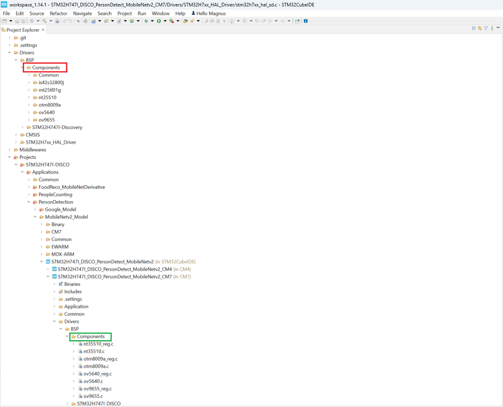

magnus_lindhe
I had a similar problem when following the tutorial above, as well as this one:
How to use transfer learning to perform image classification on STM32
Specifically, I got a linker error saying that some function related to NT35510 could not be found (some file names are removed):
undefined reference to `NT35510_RegisterBusIO'
undefined reference to `NT35510_ReadID'
in function `BSP_LCD_InitEx':
undefined reference to `NT35510_LCD_Driver'
collect2.exe: error: ld returned 1 exit status
I had followed the instructions in step 3.3 of the tutorial above (same as step 3.1.4 in the tutorial you mentioned) and moved the two files nt35510.c and nt35510_reg.c to the folder workspace/FP-AI-VISION1_V3.1.0/Drivers/BSP/Components, but the linker still didn't find them.
Solution: After a few hours of googling and trial and error, I realized that much of the project file tree is mirrored as a sub-tree of the STM32 project in the STM32Cube IDE file tree, and that I needed to drag and drop the two C-files into the sub-folder Components of the project tree. The image below shows the incorrect folder in red and the correct one in green:
I held the Ctrl key while dragging and dropping the files, to do a copy. I then got a dialog asking if I wanted to copy or link the files, and I selected linking. This seemed to update the build system so the files were included in the compilation, and solved the linking problem.
I think this should be updated in the instructions of both tutorials.
Hope it helps someone else!
