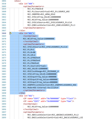

Hi @dineshsaravanan,
The issue is caused by MX, it seems that the clock config was wrong for some reason.
Here is a fix that should slove it.
Pease go to: C:\ST\STM32Cube AI Studio\STM32Cube-AI-Studio\resources\stedgeai-desktop-backend\dependencies\
and open to edit: boardExternalMem.xml
Then look for the die id 481, around line 3800 and replace the current config by this:
        <die id="481">
            <testOptimal>
            RCC.HCLKFreq_Value=160000000
            </testOptimal>
            <optimalParameters>
            RCC.SYSCLKSource=RCC_SYSCLKSOURCE_PLLCLK
            RCC.PLLM=1
            RCC.PLLN=80
            RCC.PLL1R=2
            RCC.PLL2FRACN=0
            RCC.PLL3FRACN=0
            RCC.PLLFRACN=0
            RCC.PLLSourceVirtual=
            RCC.HSE_VALUE=16000000
            RCC.MSIClockRange=RCC_MSIRANGE_4
            RCC.SYSCLKFreq_VALUE=160000000
            RCC.VCOInputFreq_Value=4000000
            RCC.VCOInput2Freq_Value=4000000
            RCC.VCOInput3Freq_Value=4000000
            RCC.USBPHYCLockSelection=RCC_USBPHYCLKSOURCE_HSE
            RCC.Mode=HSE-External-Oscillator
            </optimalParameters>
        </die>
You should have something like this:
This will be fixed in the next release of CubeAI Studio but please edit it manually if you need it before that.
Let me know if this helped.
Have a good day,
Julian

dineshsaravanan
Thanks for the support.
After applying the suggested steps, I’m now able to see the Inference Report during AED model validation on target. The issue is resolved.
