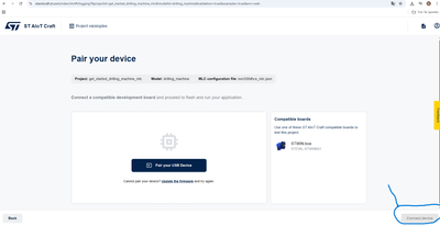

I was able to successfully pair the device using the link you provided. However, I cannot click on the "CONNECT DEVICE" button in the section I marked in the screenshot. What could be the reason for this, and how can we solve it?
Thank you in advance for your feedback.

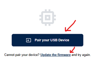

Hi @burak_Guzeller,
Thank you for choosing ST products and ST AIoT Craft web platform, I hope you will enjoy experimenting with our ecosystem.
In order to successfully log data from your device, you need to connect it to the PC and pair it by clicking the Pair your USB device blue button; in case you don't see valid devices, just update the firmware by following the provided link and repeat the pair process.
After pairing, click the Connect device button at the bottom left of the page and proceed with logging the data.
Hope this helps.
