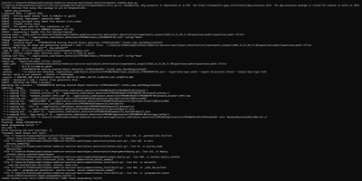

  • When running chain_qd or the deployment step for the STM32N6570-DK, the process fails at the “Board programming” stage.
  • The exception I receive is:
    common.stm32ai_local.utils.STMAICToolsError: E400: Board programming failed!
  • At the moment of failure, res_code = -1.
  • From the logs it looks like all model‑related steps (conversion, code generation, project creation) succeed, and only the board programming / flashing step fails.

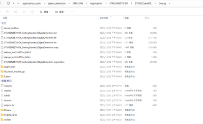

Following the suggestion there, I opened the project generated by stm32ai-modelzoo-services in STM32CubeIDE:
...\application_code\object_detection\STM32N6\Application\STM32N6570-DK\STM32CubeIDE
Then I built the project manually in STM32CubeIDE. The build completed successfully with:
  • 0 errors, 0 warnings
  • The following output files present in the Debug folder:
    • STM32N6570-DK_GettingStarted_ObjectDetection.elf
    • STM32N6570-DK_GettingStarted_ObjectDetection.bin
    • STM32N6570-DK_GettingStarted_ObjectDetection_signed.bin
This confirms that the generated project fits in the STM32N6570-DK memory and that the compilation / linking steps are fine. The issue I am still facing is only at the board programming stage when running the deployment chain from the model zoo (I get Board programming failed in the console).

Julian E.
Hi @jasonwu,
Thank you for this information.
I did successfully deploy your model with model zoo. The only issue I can see is that maybe cubeIDE1.19 could cause the issue; I've seen error due to this version.
In any case, I see that you successfully deployed it manually and I don't see anything wrong with what you described/transmitted.
