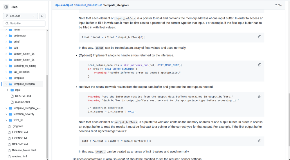

You can refer to the documentation and resources on the GitHub repository for ISPU: https://github.com/STMicroelectronics/st-mems-ispu. In particular, you can use the template specific for the integration of models converted with ST Edge AI, together with a README file explaining the necessary steps: https://github.com/STMicroelectronics/ispu-examples/tree/master/ism330is_lsm6dso16is/template_stedgeai.

The template is already allocating the memory buffers necessary to store the inputs and outputs and is communicating the location (addresses) of such buffers to the network library in the "init_network" function in "main.c", so that when you call the "stai_network_run" function to run the inference, the network will already know where to get the inputs and where to store the outputs.
For the inputs, what you need to do is to actually fill in the buffer with the correct input data, which depends on your model. Say that your input is composed of 10 float values, you can reinterpret the buffer as an array of float values with a simple cast:
float *input = (float *)input_buffers[0];
where input_buffers contains the pointers to the preallocated input buffers. If your network has only one input (it is usually the case), you will have to use input_buffers[0] (indicated the first input buffer).
Now you can access and assign the values:
input[0] = ...
input[1] = ...
input[2] = ...
input[9] = ...
What you assign to every single value depends on your application and how the input is generated starting, for example, from the sensor data (you can refer to the examples at https://github.com/STMicroelectronics/ispu-examples/tree/master/ism330is_lsm6dso16is for how to access sensor data).
After running the inference, the output of the network will already be stored in the output buffer, but you will have to again interpret it correctly based on your knowledge of the shape and format of the output of your model. Information about format and shape of both inputs and outputs is available in the "network.h" generated file. However, keep in mind that you still need to know what each value represents.
So, say your model has two 8-bit signed integer values as output, you can access them as follows:
int8_t *output = (int8_t *)output_buffers[0];
output[0] // first output value
output[1] // second output value
you can then use the output for further processing or you can copy the values to the ISPU output registers. You can do the latter with something like this:
cast_sint8_t(ISPU_DOUT_00) = output[0];
cast_sint8_t(ISPU_DOUT_00_B) = output[1];
I hope this clarifies your doubts.
