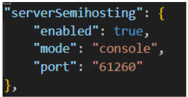

#2 Semi-hosting for ST-LINK GDB server
The semi-hosting support can be enabled in three modes:
  • Console mode – allowing users to have I/O console interaction with the target
  • All mode – (console + file) allowing users to write data also from the target to a file on the host
The ST DAP adds a new set of attributes to enable and configure semi-hosting.

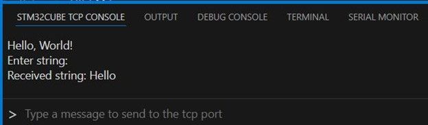

This addition into the DAP comes with a minimal TCP/IP console allowing developers to interact with the target when using the Console mode:

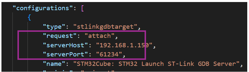

#3 Attach to remote debug server
Attach debug is a recent feature available in previous versions.
The attach debug mode decouples the GDB-client launch from the GDB-server launch. The main use case is to allow developers using Visual Studio Code to connect remotely to another PC where the STM32 target is connected over the network. Consequently, developers must also specify the serverHost and the serverPort.
A secondary use case is to launch the GDB server in persistent mode on the same PC as Visual Studio Code, to speed up the debug launch sequence.
More details on how to launch the GDB-server are documented in the ST-LINK GDB server manual.
