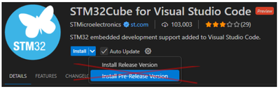

NEW STM32CubeIDE for Visual Studio Code: from prerelease to official release
Related products:STM32 software tools
Since May, we have been offering a prerelease version (3.x) of the STM32CubeIDE for Visual Studio Code extensions. This version gave early adopters access to the latest features and improvements.
These enhancements have now been merged into the official release version (2.x), marking a key milestone in the deployment of STM32CubeIDE for Visual Studio Code.
What is changing for developers?
  • Release tracks are merged: the prerelease, which is version 3.x of our extensions, is merged back into the 2.x release track. Moving forward, all developers will enjoy one single 3.x version, integrating all extensions and main packages.
  • Automatic user migration: all VS Code users previously working with the 2.x release track will migrate to the 3.x version of our extensions. We have replaced the complete tool architecture, but we expect minimal end-user disruption.
  • Transition to VS Code extension pack: developers previously relying on the 2x version, and who used to have a single STM32 for Visual Studio Code extension, will now find around fifteen STM32 extensions. This extension split paves the way to greater installation flexibility and improved maintainability.
  • Transition from CubeCLT to cube bundle manager + CMSIS-PACKs: the new VS Code extension version removes the CubeCLT dependency. Instead, we introduce the cube bundle manager that automatically downloads, installs, and updates CLI tools and STM32 device support. Developers no longer need to install a full new CubeCLT package to access the latest compiler or benefit from the latest STM32 device support. CubeCLT will later be deprecated.
  • Debugging improvements: version 3.x uses the ST custom DAP instead of Cortex® debug DAP. Developers will need to create new launch configurations to access new debug features like improved RTOS debug.
