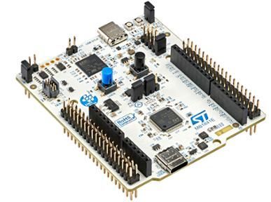

Our NUCLEO-U385RG-Q board ran a keyword spotting workload at over 48 inferences per second while drawing
only 245mW. This remarkable efficiency is unlocked by the STM32U3's groundbreaking near-threshold design (a first for the STM32 family), which drastically reduces dynamic power consumption. This is a significant step forward as it cuts energy costs by nearly 6x compared with the STM32L4 and 2.5x compared with the STM32U5. For battery-powered IoT devices, this combination of high performance and ultra-low power finally eliminates the traditional trade-off between intelligence and battery life.
