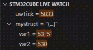

#1 Live data watch
This feature is one of the most appreciated in STM32CubeIDE. The latest update of STM32Cube for VS Code provides a first version of the live data watch capability, which allows users to:
  • monitor any type of data object in real-time.
  • keep monitored variables across debug sessions.
The live expression feature is set up inside launch.json by adding the following lines:
