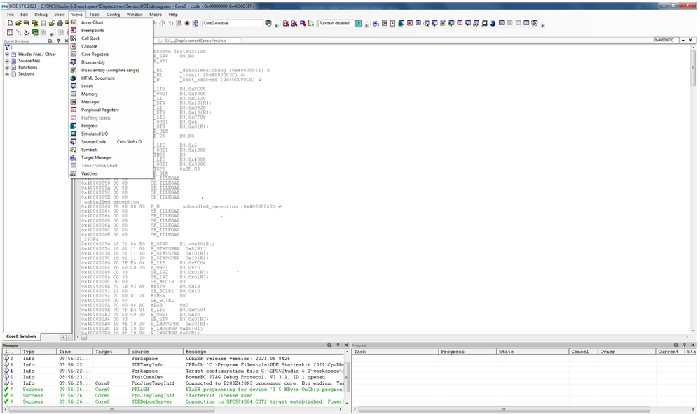

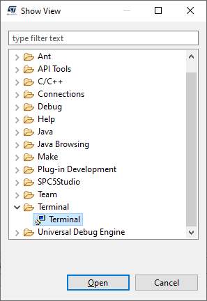

Hi, may i know how to open the serial monitor on UDE STK ?
i have been search whole day to monitor my adc value but i didn't found the serial monitor.

‎2022-08-16 8:28 AM
hello,

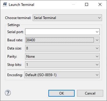

you can find a terminal in SPC5Studio in menue Winow->Show view->Other
then select terminal:and select the bad rate at 38400 for our Demos:
Best regards

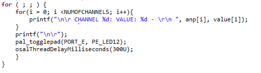

why it do not print anything ? i try the example on SPC57S and successfully compile and connected but it does not show anything, it do not print the channel and value. May i know why?

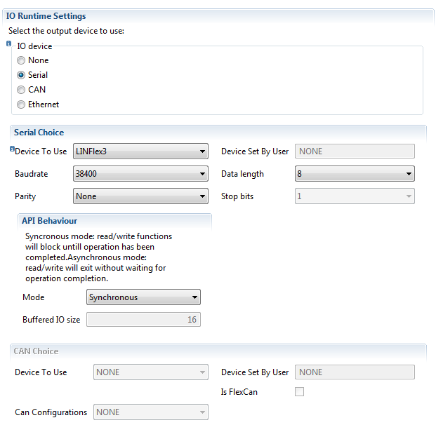

to use printf command as debug in your main program,
you need to add and configure this component to your project:

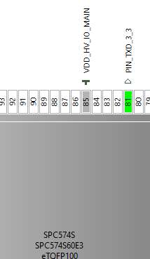

and configure the TX Serial pin PA[12] in Pinmap editor:

Is it correct the driver that i set? btw im using the the PD[14] as my serial pin.

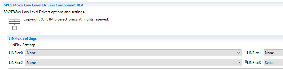

So I suppose you are using SPC574S
then you also have to enable serial driver and configure in Low Level Driver the LinFlex3 as serial:

yaa i already set the LinFlex3 in Low Level Driver but it do not show anything on serial. I try to check again the connection and try with the serial demos. The word HELLO WORLD just showing fine in my serial. But when i try to print my ADC value, it did'nt show anything

If your serial demo is working fine, it means your pinmap and driver configurations are good
you should see this pinmap config:and this driver config:
do the same configuration in your saradc demo, and it should work either.
