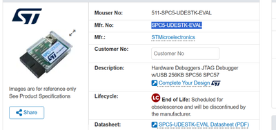

Thanks, Erwan for your immediate response.
The link which you have given shows that the product was obsolete,
So, we have purchased AEK-MCU-SPC5LNK. for our SPC560P microcontroller. We have UDE STK software which we were previously using it for SPC5-UDESTK debugger.
Is there any possibility to use AEK-MCU-SPC5LNK along with UDESTK software? Can we flash, debug our SPC560P microcontroller with AEK-MCU-SPC5LNK?
If yes, please provide step by step process for it.
Thanks in advance.
The SPC5-UDESTK is obsolete. Please recommend a suitable debugger with an appropriate part number. we are using spc560p
