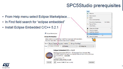

Sorry, it does not install by default :
You should install Embedded MCU from Eclipse Marketplace
Cf screenshot
Embedded CDT is nice eclipse feature / plugins to customize your toolchain in SPC5Studio or Eclipse.
Best regards
Erwan

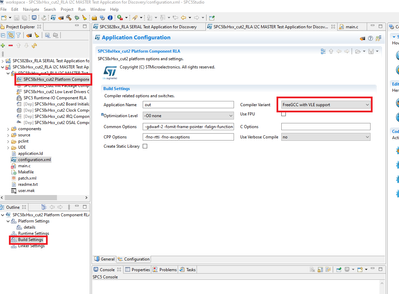

Hello ,
we are not using CDT Settings to compile a project.
the toolchain is set in the platform component
if you want to use CDT you set your toolchain in
And set your project as CDT
Best Regards Erwan

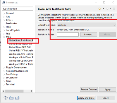

‎2023-08-25 1:06 AM
Hello Erwan,
thank you for your replay.
Sorry but i have no MCU setting under Preference, so i'm still blocking.
Best Regards
‎2023-08-25 1:23 AM
Cf screenshot
Best regards
Erwan
