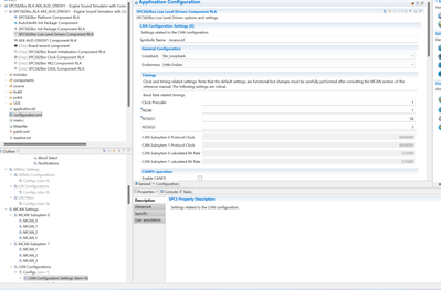

Rohit Rajapure
November 24, 2023
Thanks for the response,
CAN setting option is No_loopback, as you can see below,
can you guide more detail about how to set this things if we want build the custom project?
Regarding the testing, we are using can analyzer to send some data, we are just checking the Rx part not transmitting part,

November 24, 2023
If you did not change anything from the example baud rate is 500. You selectvit with clock prescalar. I do not understand the clock setting myself bjt I found a way to switch between 250, 500 and 1000, a bit try and error I guess.
Next thing: watch out for extended or standard frame. This is set up int the rx receive filter settings. Just double click the filter.
If you look here for my posts you can find a CAN thread which resolved some mysteries to me. Other than that I just went through the Application Note- you can find that also in the other thread.
