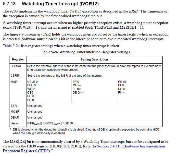

I don't think I have a timer enabled.  I don't see the WDT setting in the outline, but in the configuration.xml it is disabled.  Most importantly clock_cfg.h is  generated as '#define SPC5_DISABLE_WATCHDOG               TRUE'.
However, almost randomly, I am getting an IVOR12 interrupt:
PC 0x00000380
CR 0x44000004
LR 0x00002D78
CTR 0x0
That said, the system runs for ten minutes, one minute, or five, then hangs up in IVOR12.  The only driver I am using is the serial drivers, and may there is an issue there?  It even triggers the ivor when degugging, which I thought the WDT was disabled for debugging as well.

The watchdog is disabled on SWT IP but not in e200 Core (HW WD)
#if SPC5_DISABLE_WATCHDOG
 /* SWT disabled.*/
 SWT.SR.R = 0xC520;
 SWT.SR.R = 0xD928;
 SWT.CR.R = 0xFF00000AU;
#endif
About IVOR12,
the HW Watchdog is enabled by mtMSR (cf boot.s)
 * MSR default settings.
#define MSR_DEFAULT (MSR_SPE | MSR_WE | MSR_CE | MSR_ME)
(cf chapter e200z4 document)

Posted on March 27, 2018 at 10:26
Hello Matthew ,
According to your description,
Your issue seems to be a coredump issue or a stack overflow issue.
A stack overflow could generate a watchdog or a memory corruption
could you check the state of your stack (cf memory windows) during the IVOR1 ?
it should be located between __process_stack_base__ and __process_stack_end__
.core0_stacks : ALIGN(16) SUBALIGN(16)
 . = ALIGN(8);
 __irq_stack_base__ = .;
 . += __irq_stack_size__;
 . = ALIGN(8);
 __irq_stack_end__ = .;
 __process_stack_base__ = .;
 __main_thread_stack_base__ = .;
 . += __process_stack_size__;
 . = ALIGN(8);
 __process_stack_end__ = .;
 __main_thread_stack_end__ = .;
 } > ram�?�?�?�?�?�?�?�?�?�?�?�?�?�?
Could you increase the Core 0 Process Stack size in order to check the issue is happennign again ?
