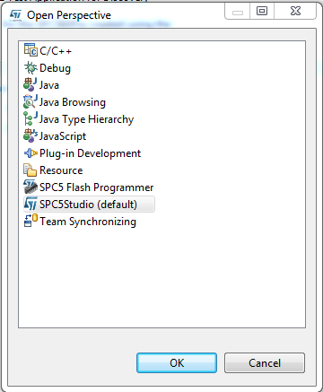

Could open and reset the eclipse perspective in SPC5Studio ?
you should recover the Application Wizard
