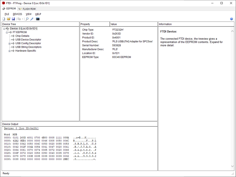

Erwan YVIN
Hello Konstantin ,
could you check your PLS USB/JTAG by FT_Prog
https://ftdichip.com/utilities/ ?
Best regards
Erwan
KShar.5
Device is detected. What I should be looking at?

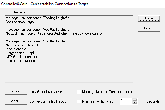

KShar.5
UDE STK still doesn't connect:
Connection failure report: https://pastebin.com/raw/etf6iDiq

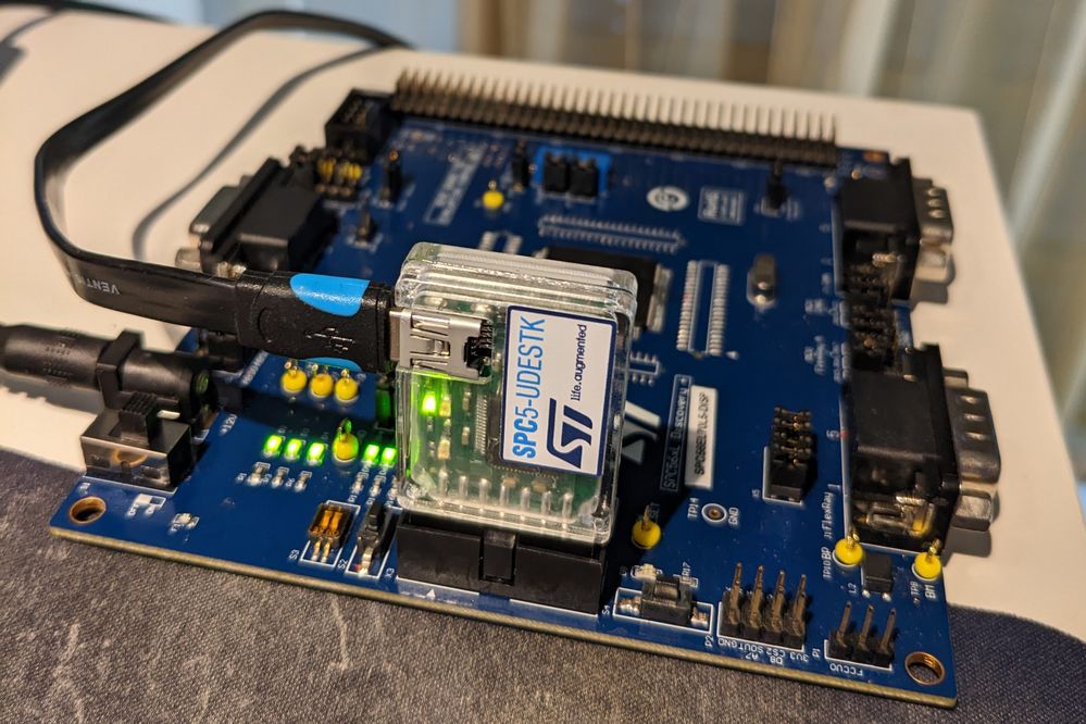

KShar.5
Photo of the device, connected to the EVB:
