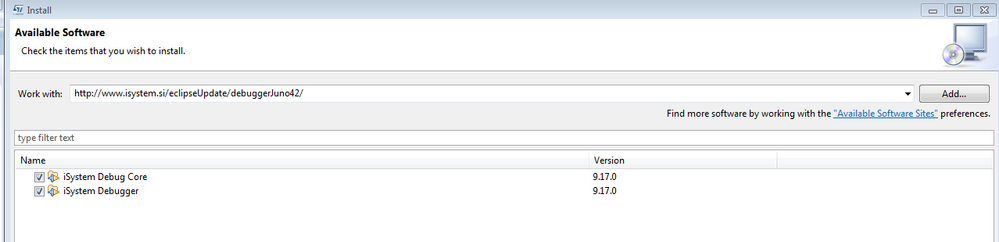

which debug tools can be support when use SPC5 Studio?
Whether SPC5 Studio IDE support IC5000 (debug tool) or not? or only support PLS-UDESTK tool ?
Solved! Go to Solution.
2017-09-29 12:10 AM
Hello Gary ,
We do not support officially
IC5000 (debug tool)
we support only
PLS-UDESTK tool
on our differents Test Application
Anyway , SPC5Studio is a Luna Eclipse based IDE with CDT installed
you can install it on the update site and create an associated ISYSTEM Debug Configuration
Best regards
Erwan

2017-09-29 2:53 AM
Hello Erwan;
Thanks for your quick reply,
i have another question, Besides SPC5 Studio IDE, what's IDE software PLS-UDESTK can also be support? whether ST have dedicated programming software supported by PLS-UDESTK ?
2017-09-29 3:03 AM
In fact , in each test application , we add a debug.wsx (UDE Workspace) compliant for PLS UDE
http://www.st.com/en/development-tools/spc5-udestk.html
Best Regards
Erwan
