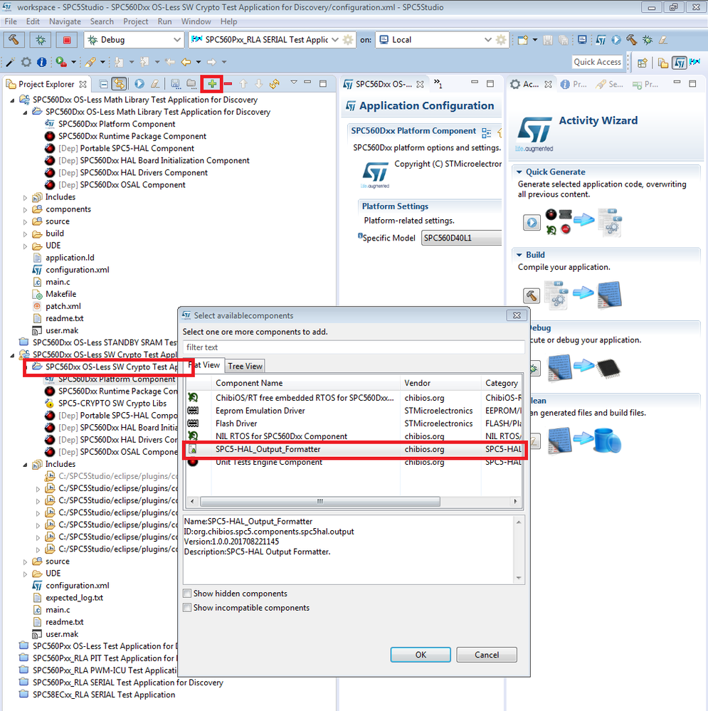

Erwan YVIN
Posted on September 28, 2017 at 09:10
Hello Fabio ,
I think that you use SPC5Studio.
You can use the Ouput Formatter to perform this task. (RLA or HAL)
    Best Regards
                      Erwan
