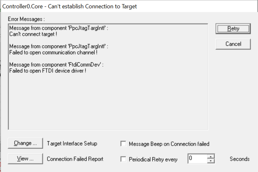

Problem in connecting to the target SPC560Bxx Disc board

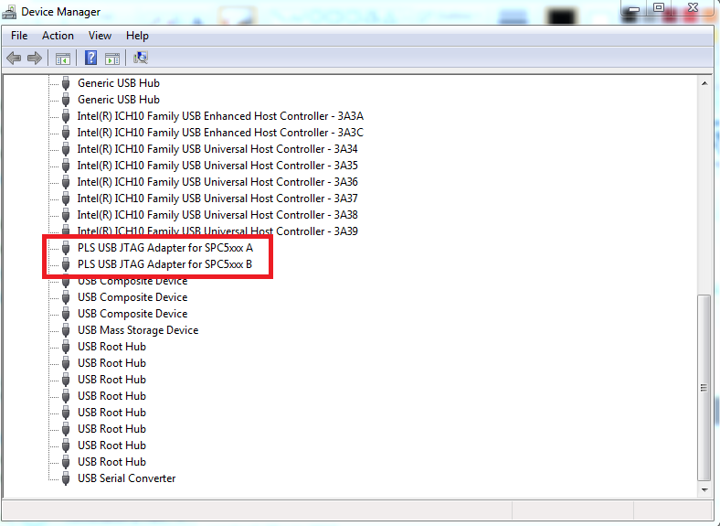

Hello , Could you check your device manager ?
You should see PLS USB JTAG
if not , install the drivers located in
c:\Program Files (x86)\pls\UDE 4.10\Driver\
Best Regards

prashanth.mohan22
Hi @Erwan YVIN​ ,
I've connected the device to my PC. The lights are glowing on the board, but the PC is not detecting it as USB and hence no COM ports are assigned to it. Is it a problem with the SPC560B-DIS hardware?
My other SPC560B-DIS board is working fine. Help me resolve this issue.
