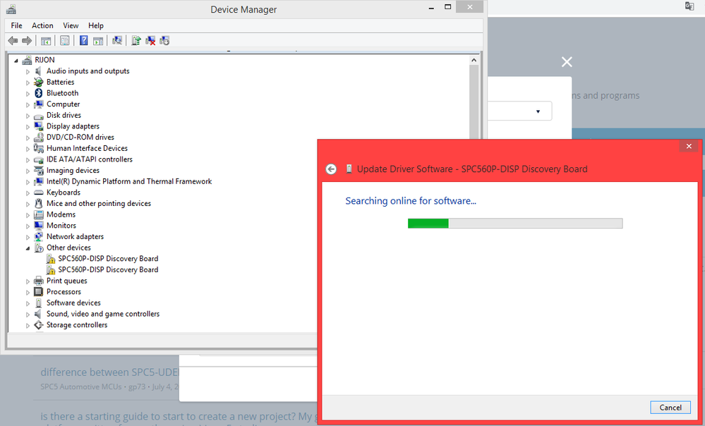

How to install driver SPC560P ?
RFabe
i cant find way for install this driver, can anyone help me..
1 REPLY 1
zambrano.luigi
you can download the debugger (that includes the drivers needed) from the following link
https://www.st.com/content/st_com/en/products/development-tools/software-development-tools/spc5-software-development-tools/spc5-udestk-sw.html
Best Regards,
Luigi
