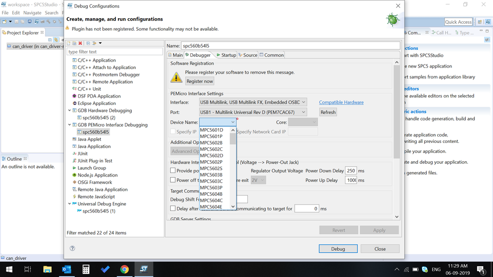

I've PEMicro Multilink Universal debugger and I would like to configure debug functionality in SPC5Studio IDE.
But, unfortunately, I couldn't able to see our device listed in Debug Configuration.
Attaching Screenshot:
Please let me know the device to choose to support SPC560B60L5 MCU core.

PEmicro has extensive support of SPC devices, but they aren't in the default plugin for SPC5Studio. We are currently working on a patch to show the SPC support and allow you to select your device. This patch will take a few weeks. If you go to the PEmicro website, you can create a Support Request so we can update you when the patch is ready.

Could you please let me know a work around for this in the meantime?
I have heard SPC560Bx shares the same core with a particular MPC series of NXP. Could you please select that MPC core as a device and give a try?
