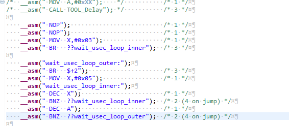

Hi all,
Dear all ST's expert, somebody help me out, Thank you very much.
An errors occurred while compiling, see below:
assembler code:
build result:
IDE: SPC5 Studio, version: 5.8.1
Compiler: FreeGCC with VLE support
or Hightec Pro
Solved! Go to Solution.

2019-08-30 2:09 AM
Hi Erwan,
I am using SPC560B50L1.
Best Regards
zeke
2019-09-02 7:32 AM
Hello ,
SPC560B50L1 is part of e200z0 family
"The e200z0h core is a single-issue, 32-bit Power Architecture technology VLE-only design
with 32-bit general purpose registers (GPRs). All arithmetic instructions that execute in the
core operate on data in the general purpose registers (GPRs).
Instead of the base Power Architecture technology support, the e200z0h core only
implements the VLE (variable-length encoding) APU, providing improved code density."
For assembler code , please refer to the document e200z0RM.pdf
Best Regards
