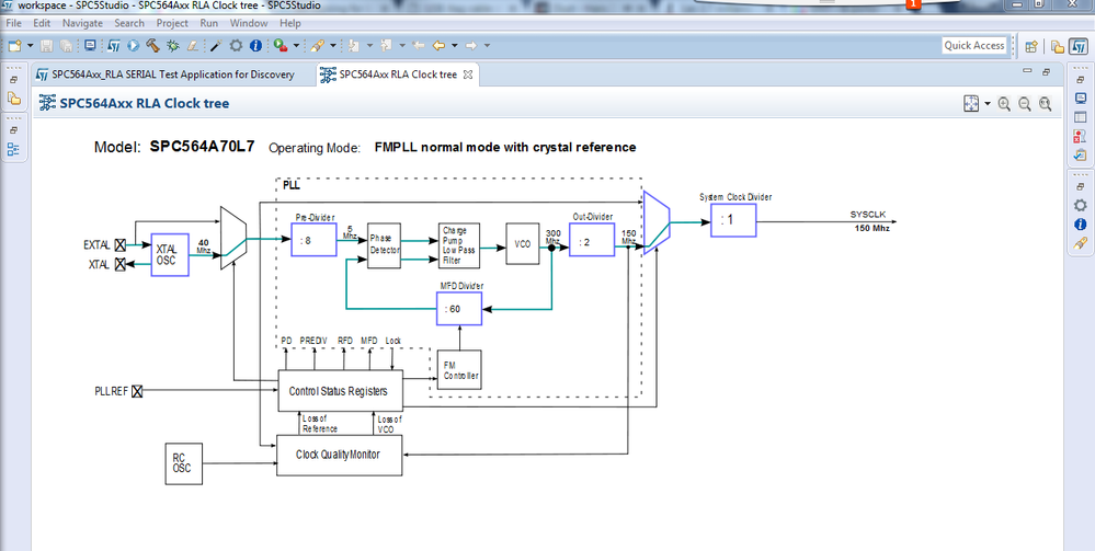

Step 1
Support for 50MHz system clock generation
The oscillator and PLL support generation of a 150 MHz system clock while using the 40 MHz crystal required for FlexRay operation. A possible PLL configuration is shown below: �?
Input clock (crystal frequency): 40 MHz
�? EPREDIV/IDF divider = /8 (1–15 range supported) �? EMFD/NDIV loop divider = 80 (32–96 supported) �? VCO clock out = 300 MHz (256–512 MHz range supported) �? ERFD/ODF output divider = /2 (/2, /4, /8, /16 supported) �? SYSDIV divider = /1 (/1, /2, /4, /8, /16 supported) �? System clock = 50 MHz
Step 2
wait for Lock the PLL
Step 3
�? EPREDIV/IDF divider = /8 (1–15 range supported) �? EMFD/NDIV loop divider = 60 (32–96 supported) �? VCO clock out = 300 MHz (256–512 MHz range supported) �? ERFD/ODF output divider = /2 (/2, /4, /8, /16 supported) �? SYSDIV divider = /1 (/1, /2, /4, /8, /16 supported) �?
System clock = 150 MHz
Step 4
==> It is ok for my side

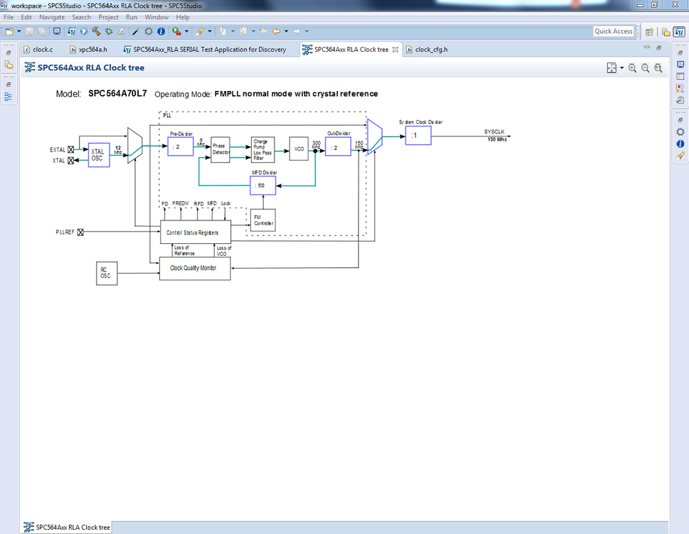

You can use SPC5Studio (SPC564A80B4 ClockTree) and enter your own values :
Take any application from Application Wizard
   Best regards
                   Erwan
Mahesh Chamaraja
Posted on January 25, 2017 at 05:53
Hellow Erwan,
 Clock configuration :
FMPLL.ESYNCR2.R = 0x00000001;/*ERFD->2*/
FMPLL.ESYNCR1.R = 0xF007003C;/*EPREDIV->8,EMFD->60*/
while (FMPLL.SYNSR.B.LOCK != 1) {}; /* Wait for FMPLL to LOCK */
FMPLL.ESYNCR1. R |= 0x70000000;/*Again configured normal mode with crystal reference*/
I got system clock 74.88Mhz, verified system frequency by generating SCK frequency

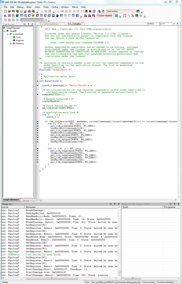

Erwan YVIN
Posted on January 25, 2017 at 14:59
Hello Manesh ,
Your clock configuration is good.
I have tried with PLS Environment & SPC5STudio 5.0 with SPC564A70L7
it is ok , no problem with flash , debug.
You should focus your investigation on TRACE32 / LAUTECHBACH.
I am checking with an other team which uses TRACE32.
  Best regards
                    Erwan

Erwan YVIN
Posted on January 26, 2017 at 17:22
Hello Manesh ,
1 ms timer and internal Watchdog are not a problem
regularly in SPC5Studio and SPC56 Family, we use 1ms tick timer on PIT (Chibios , NIL and Os-Less)
For the debugger , you should disable the Watchdog before connect on PLS
TRace32 it should be the same.
// disable watchdog
SET SWT_SR 0xC520
SET SWT_SR 0xD928
SET SWT_CR 0xFF00000A
For FlexRay, you should take care of the clock and the status error of the Flexray controller.
