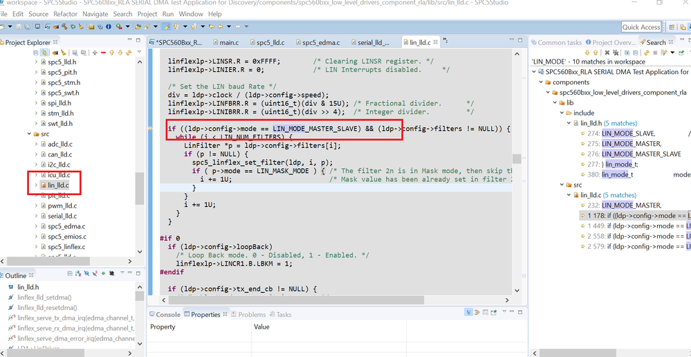

I have a using eval board : SPC58EC-DISP.​
I try to receive all packet (slave mode) just like DAQ.
SPC STUDIO support LinFlexD example only using filter.
I think that lin_lld.c - spc5xx_lin_rxi_interrupt (SPC STUDIO Example) is need to modified.
Please tell me if you know that receive way to data without filter in slave mode.

You can update this codeif you want by using the patch mode feature of SPC5Studio
the generation will keep your manual patch
