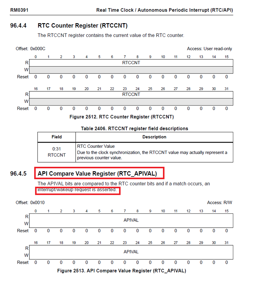

2017-10-25 4:52 AM
Yes, with RTC you can put 5 hours you have just find the good Compare Value register
(RTC_APIVAL)
Best regards
Erwan

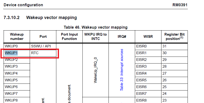

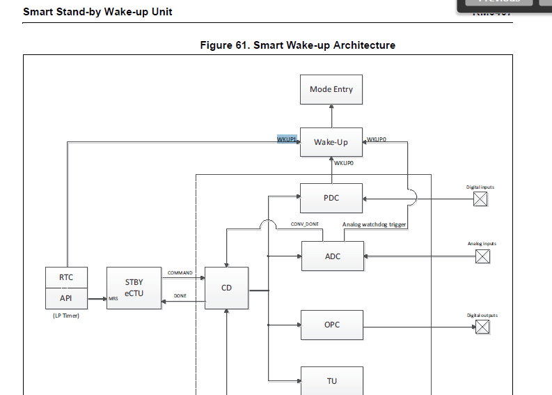

2017-10-25 11:31 PM
Yvin.Erwan
Thanks for the input.
I gone through the RTC chapter. By using set of registers in RTC we can achieve this.
But I have3 questions.
1. How to enable RTC in Standby mode or default it is enabled ?
2. Which is the clock source for RTC and How to configure it (which are the registers need to program)?
3. Is there link between RTC and SSWU? After 5 hours system needs to wakeup according to this RTC interrupt will trigger SSWU for system wakeup? I have attached the image which shows the relation.
2017-10-31 3:04 PM
Hello Shiva ,
After checking the RM , there is no PCTL associated on SPC58 Family
I think that RTC is not switched off in Low Power Mode. (STANDBY or STOP mode)
i will answer you next monday.
check the Chapter 96 for the specific registers for RTC
Best Regards
Erwan
2017-11-01 8:54 PM
Yvin.Erwan
I started coding I have put ???? in where I need support. Pls see the below code.
/* MCU registers to enable RTC */
/* Clock configuration to RTC in stanbymode */
/*--------------------------------- STANDBY configuration ------------------------------------*/ PMCDIG.MISC_CTRL_REG.B.SIRC_ENB = 0; // Enable SIRC in running modes LPRCOSC.CTL.B.LPRCON_STDBY = 1; // Enable SIRC in STANDBY /*WAKEUP registers program */ WKPU.WRER.R |= 0x02; /* Enable Wakeup1 which is connected to RTC module */ /*RTC module configuration */ RTC_API.RTCS.B.RTCF = 1; // Clear the RTC flag by writing 1 RTC_API.RTCC.B.CNTEN = 0; // reset the counter RTC_API.RTCC.R = 0x80009001; //start RTC counter :CNTEN = 1 , APIEN= 1 , CLKSE = 01 , TRIG_EN = 1 used, Trigger enabled */ RTC_API.RTCVAL.R = 0x0009C400; // T=5sec OR /* In these two registers which one we should use ?????? */ RTC_API.APIVAL.R = 0x00001000; // API period =25msec /* Interrupt Handling */??????????
