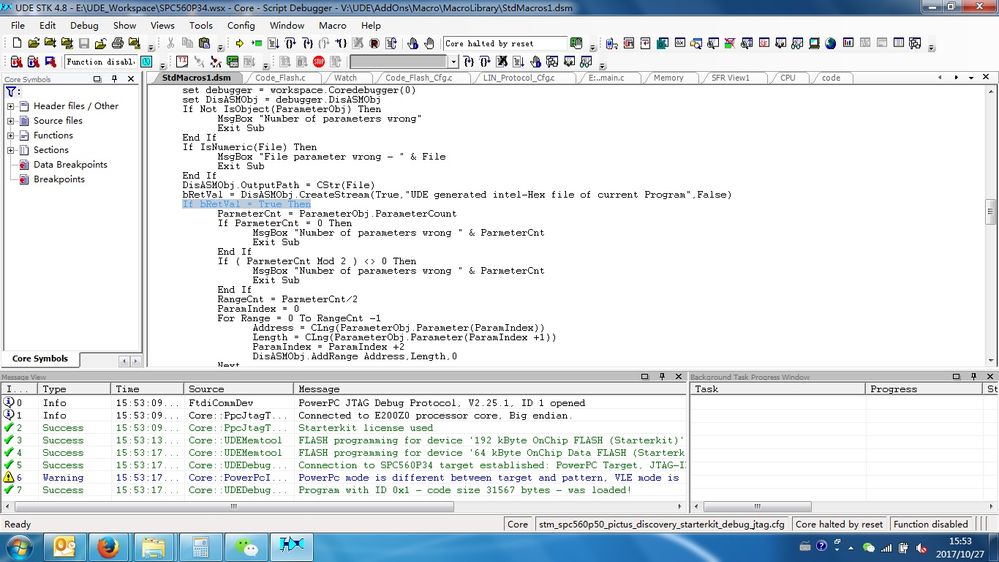

Posted on October 27, 2017 at 03:41
I got the following information:
'_______________________________________________________
'    SaveHEX command line function
'    generates intel-HEX file
'    command line SaveHex output-file range1 [range2] [range3] .....
'    range description:
'        <startaddress>,<length>

In the following, what should I insert into it? Could I insert something into it like this ''Application.hex 0x0~0x7FFF''?

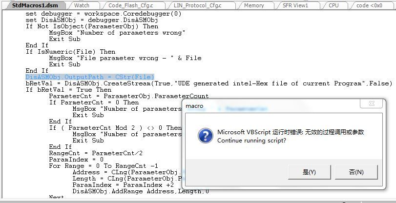

Posted on October 27, 2017 at 04:04
The instructions suggest something more like
SaveHEX Application.hex 0,0x8000
Posted on October 27, 2017 at 04:13
I do it like this: Application.hex 0x0,0x8000
and I got the following error.
Erwan YVIN
Posted on October 27, 2017 at 10:39
Hello Zhang ,
You have to run the script
there is a button to do that
and check the Windows directory
      Best regards
                Erwan
Posted on October 27, 2017 at 09:38
Hello Zhang ,
You should enter Application.hex,0x0,0x8000
the hex file will be in c:\windows directory.
Are you administrator of your PC ?
           Best regards
                         Erwan
Posted on October 27, 2017 at 09:59
Yes, I'm the administrator of my PC and I can install some software in my PC. I enter ''Application.hex,0x0,0x8000'' and after the following it will go to the end.
Posted on October 27, 2017 at 10:50
I use the following buttons and there is no Application.hex in the Windows directory.
Posted on October 27, 2017 at 14:01
Hello Zhang ,
No , You should run the macro script not the embedded software.
         Best regards
                            Erwan
