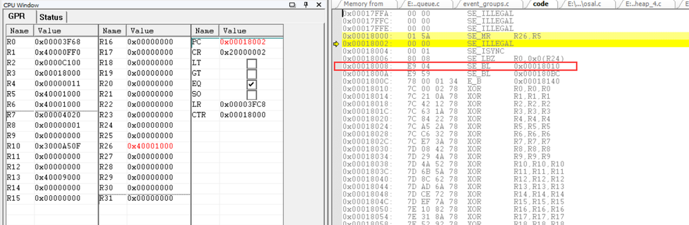

My APP address is 0x18000, i did test.
if i wrote:
e_lis% r3, HI (0x00018000)e_or2i% r3, LO (0x00018000)mtctr% r3se_bctrlJump failed.I must write:e_lis% r3, HI (0x00018008)e_or2i% r3, LO (0x00018008)mtctr% r3se_bctrlJump success, MCU can be executed to the APP main function, but the implementation of abnormal ....Please tell me, before jumping program, how should I do?
My bootloader Jump code:
//irqIsrDisable(); //can_lld_stop(&CAND1); CAN_0.MCR.B.MDIS = 1; // disable FlexCAN//can_lld_stop(&CAND2);
CAN_1.MCR.B.MDIS = 1;//can_lld_stop(&CAND3);
CAN_2.MCR.B.MDIS = 1;// PIT.PITMCR.B.MDIS = 1; /* PIT clock Disabled. */
//SPCSetPeripheralClockMode(SPC5_PIT_PCTL, SPC5_PIT_STOP_PCTL);//INTC.MCR.B.HVEN = 1;
SPCSetRunMode(SPC5_RUNMODE_DRUN);
(*(AppFunctionType)(JMP_ADDRESS+8))();
But it is not working good...

When I connect the debuger and debugging , everything is fine�?When I disconnect debugger and close the UDE, and re-power on the board, the jump is unsuccessful.
2017-11-06 8:18 PM
When I use 8M
oscillator
, there will be the above jump failure, when I use 8Mcrystal
, everything is no problem.
