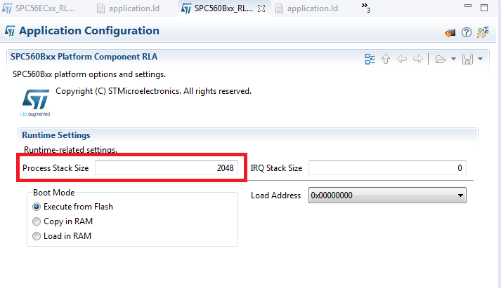

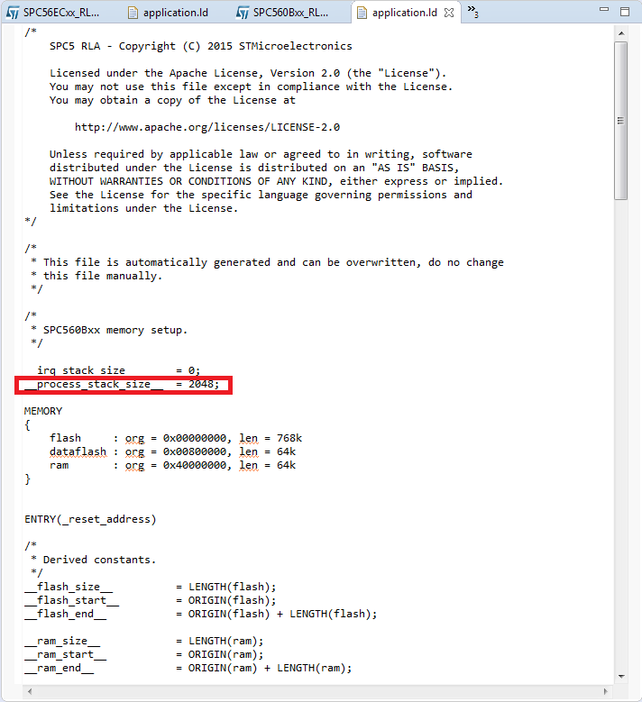

Erwan YVIN
Posted on February 16, 2018 at 10:09
Hello Thomas ,
  • if you want to update a SPC5Studio demo, you can update this following configuration , save and generate
  • If you want to use your own linker file
        in SPC5Studio, rename application.ld by user.ld
and you can customize your stack size by updating this following value
             Best Regards
                            Erwan
