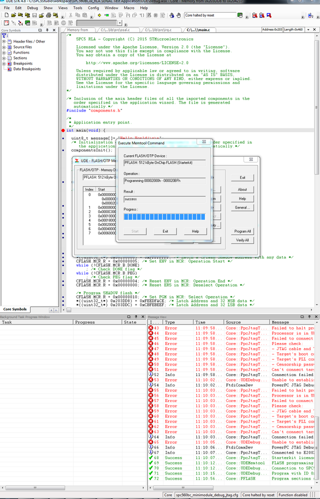

Hello Everyone,
I am working on SPC560C50L3 controller and using UDE STK 4.8 software for loading the firmware. I wanted to enable censorship. After going through the community I was able to get a code to erase shadow flash an enable censorship from below link.
https://community.st.com/0D50X00009XkXR7SAN
I took the SPC560BCxx_RLA Flash Test Application from SPC5 Studio which runs from RAM. I commented CFlash and DFlash testing part along with the Shadow flash locking from the above code. Then I copied the code for enabling the censorship from the above link and build it. Then using the JTAG and UDE STK 4.8 I loaded the code to my MCU step by step using the Debug option. After power on reset, my MCU is running my application code (not the example). But I am not able to update new firmware because JTAG is not connecting to target.
Message from component 'PpcJtagTargIntf' :

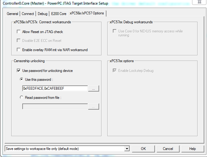

Can't connect target !Message from component 'PpcJtagTargIntf' :Failed to connect probably because of wrong processor state !Please check:- JTAG cable and Target Power- Target's boot configuration- Target's PLL configuration- Censorship password configuration !Message from component 'PpcJtagTargIntf' :Processor is in UNKNOWN state !Message from component 'PpcJtagTargIntf' :Failed to halt processor !I have already tried the censorship unlock feature under xPC56x/xPC57 Options in UDE STK 4.8. I have also tried reversing the password. Password I used is the default password (0xFEEDFACE,0xCAFEBEEF). Did I enable the censorship correctly, or did I miss something. Any suggestion would be helpful.

Have you enabled 0xFEEDFACE,0xCAFEBEEF in your debug configuration ?

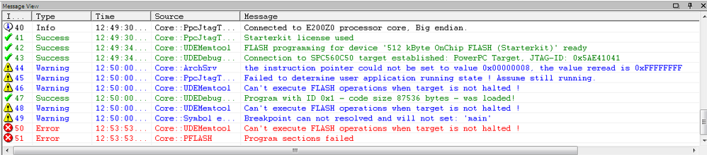

I tried to follow your instructions and if I power ON my module soon after pressing ''Retry'' option, I am able to connect to SPC560C50 target. But when I select my hex file or even try to program the module, it is giving the error as shown below.
I think the UDE STK software is trying to reset my module several times while trying to program. I was able to erase my flash one time. After that I am not able to erase or program it again.
Regards
Thomas

Hello Thomas ,
Good news , your target is not locked.
you should check in your PLS Debug options
'Reset target when connect'
Best regards
Erwan

I tried every options in the PLS Debug options, still I am not able to load any firmware to the MCU. I can only erase my flash when I power on my MCU just after clicking the Retry option. I tried it on another controller also, the result is same.
When I try to select my hex file, I get the below warnings.
what does the warning at 44 mean ? when I try to program, errors at 50 and 51 are occurring.
