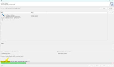

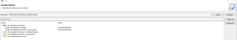

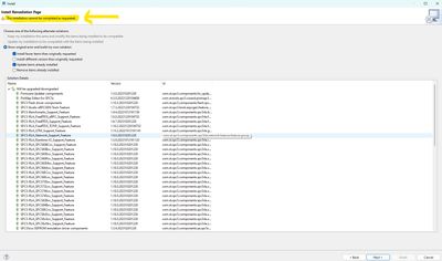

‎2024-01-10 3:06 AM
Tried installing the git for eclipse as given in the previous post but the installation is failing. It is showing
"The installation cannot be completed as requested".
Attaching the screenshots here.
Could anyone please help with this?

‎2024-08-15 1:10 AM - edited ‎2024-08-15 1:10 AM
The issue is, the latest EGit is not compatible with SPC5 Studio. Hence we need to install the older version of EGit.
Go the archives and select one of the older version to enable EGit.
Archives Website: https://archive.eclipse.org/egit/
I have installed https://archive.eclipse.org/egit/updates-5.10/ and it works fine.

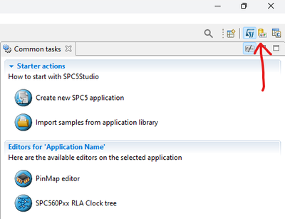

‎2024-08-16 1:00 AM
Once it is installed, Go to Window -> Perspective -> Open Perspective -> Other and in the pop window select Git. Now you will be able to see the Git Tab in the top right corner.
Hope this helps.
