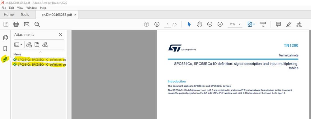

BKuma.3
Dear Luigi,
This attachment is not found in the pdf file. Can you please help on this.
cannot able to locate the paper clip symbol as per the instruction on the document.
Regards
Bipin.
zambrano.luigi
Senior III
Hi Bipin,
please, see the following picture
Regards,
Luigi
BKuma.3
Dear Luigi,
Thank you so much for the help. That was an issue with PDF Reader version.
