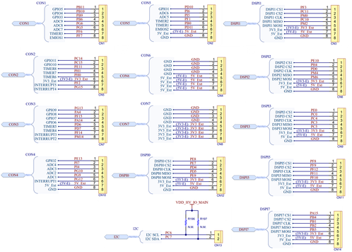

Go to SPC58EC 4M Mini board view. This looks strange. Cannot scroll down to view the AEK-POW-BMSNOTX wiring allocation. If I zoom out then I can see the connection wiring table and it is a mess. Expected SPI connections to all be on CN12 (dspi0), and NTC and FAULT to be at meaningful locations.
CS0: CN1-1
MISO: CN12-4 (ok)
MOSI: CN2-6
SCK: CM12-3 (ok)
FAULT: X
eNTC1: X
eNTC2: CN16-13
eNTC3: X
eNTCb: CN16-14
Why is it selecting random pins like this?
Can I somehow adjust the pin mapping to some more sane use of the connectors?

BMSCHAIN allocation on AEK-MCU-C4MINI is not implemented.
It works only with AEK-MCU-C4MLIT1.
In any case, you have the freedom to move the pins directly from the Pinmap after the allocation. Just to avoid to change the code, keep the exact name and pin configuration as allocated.

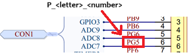

The golden rule to make a system work is that "all the pins displayed on the connection matrix MUST be connected". So your GPIOS and NTCs have to be allocated manually to some available MCU pin.
To do that you should take a look to the AEK_MCU_C4MINI extended connector, which can be also found on the C4MINI User Manual.
The pins you want to allocate are ADCSAR, so you should search in the scheme above which MCU pin are allocable as ADC.
When you find it:
In red you can see which P"x"y" combination configurable as ADC (i.e. PG5)

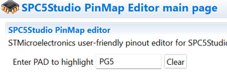

In the top left of the screen search for the pins you are looking for:
our C4MINI should have every pin allocated already, so you should see it highlighted in green.
If you click the pin, you will find it highlighted on the ADCSAR Outline window:

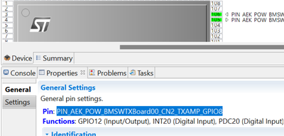

NOW, left click on the pin previously displayed with the "X" and copy the name from the General setting window:
Then right click on the PIN and deallocate it, selecting NOT USED:
Now deallocate the PG5 (if already allocated) and allocate it once again, as:
Make sure to paste the name you copied before!
Remember the name of the peripheral (ADCSAR12b_S) and the Channel number.
