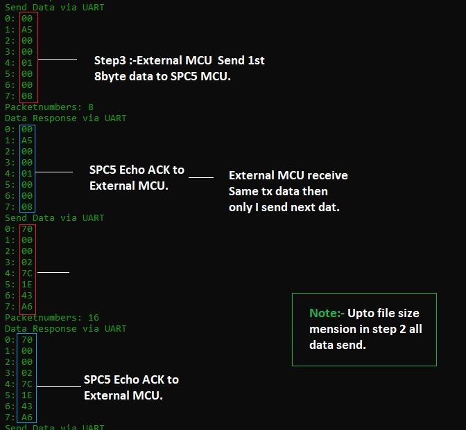

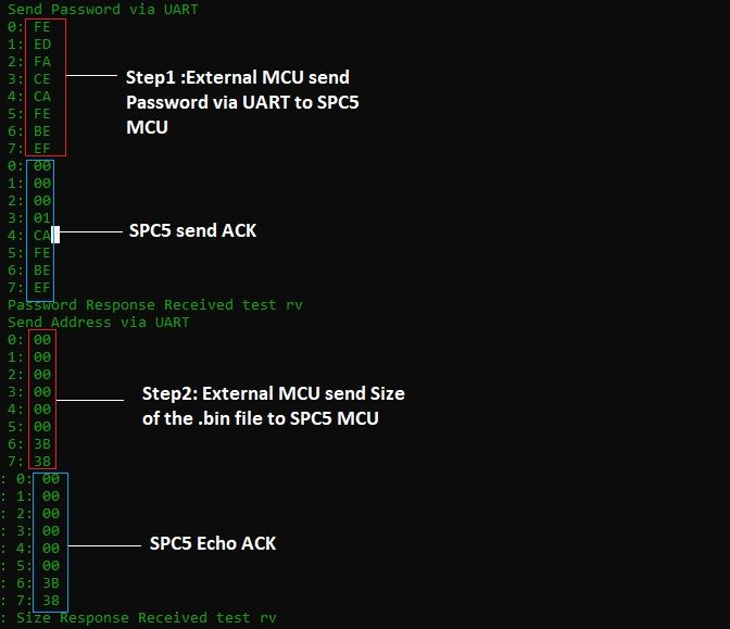

Hi Guys, I am working on SPC584B-DISP Board.In this board i need bootloader option so that i am try to use example SPC584Bxx_RLA Bootloader Test Application for Discovery 2 .In this example download code from serial UART .
Ravi S
In this I can able to download bin file from UART next step jump to app in this step not working if any one have idea please help .......
Thanks advance ...

Ravi S
Hi sir,
I print data send from External MCU and send screenshot for your reference.
Host MCU send 8byte at a time
Thanks
Ravi.S
