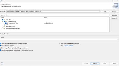

Hello ,
Yes , we have to install Live Memory View (cf screenshot)
             Best Regards
                                          Erwan

Thanks a lot.

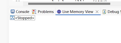

Hi
sorry for later response.
but from my practice, the live memory view below is not what I expected.
I cannot add variable into it.

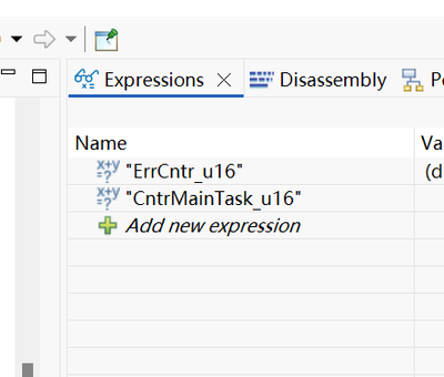

The "live expression" view should be similar to "expression" view below, but still I cannot find it  in Stellar Studio.
