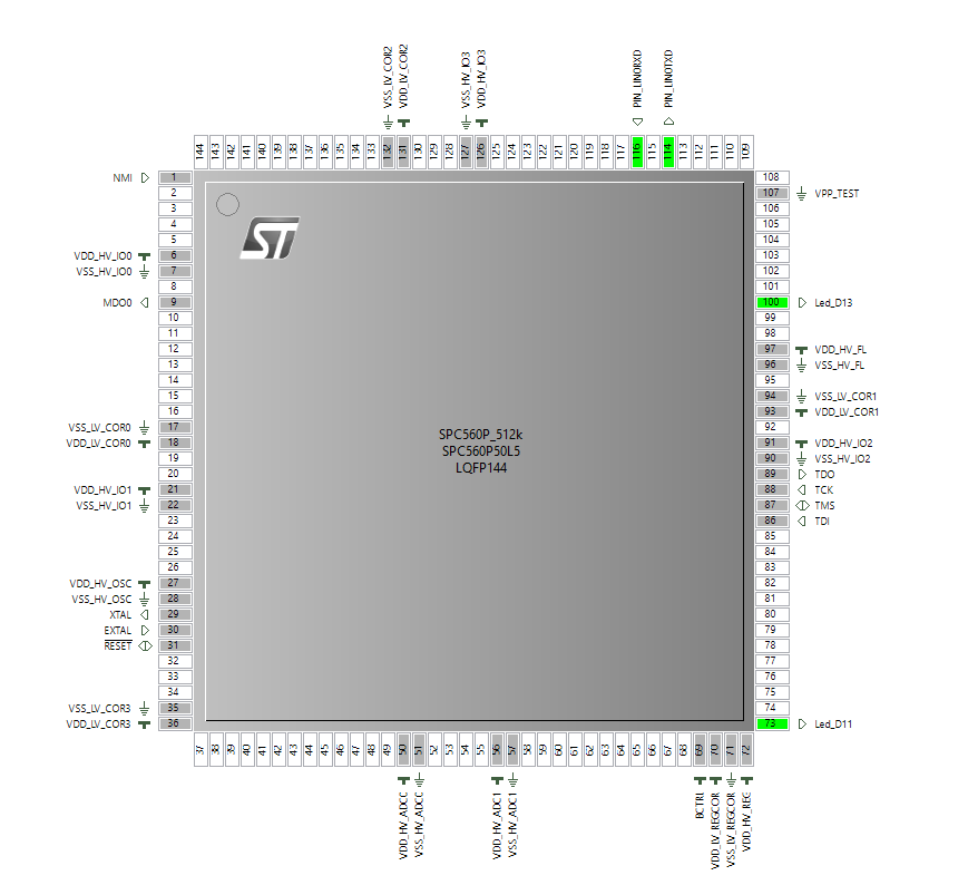

First I compile and flash RTOS serial example with no errors. then I run it. No errors were detected. same process was followed to check ADC example. There also no error were found. Then I combined both codes as follows(attached). It compiled with no errors. But it did not run smoothly. The LEDS always lit.

Your pinmap does not contain ADC Settings.
