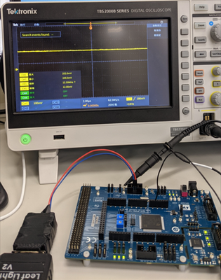

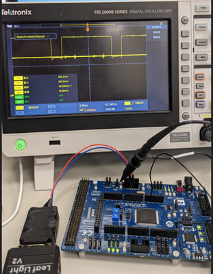

Today, I tried using an oscilloscope to measure the CANH waveform.
Below are the oscilloscope waveforms from the SPC560P-DISP I already had:
The waveform generate normally.
Next, I test the newly purchased SPC560P-DISP:
Then no waveform was generated on CANH.

Louie33Author
November 19, 2024
Thank you. I previously not consider this is a hardware-related issue. After checking JP22 and JP23, I discovered that their positions were both set to the pins for CAN channel 1, which caused data transmission on CAN channel 0 to fail.
