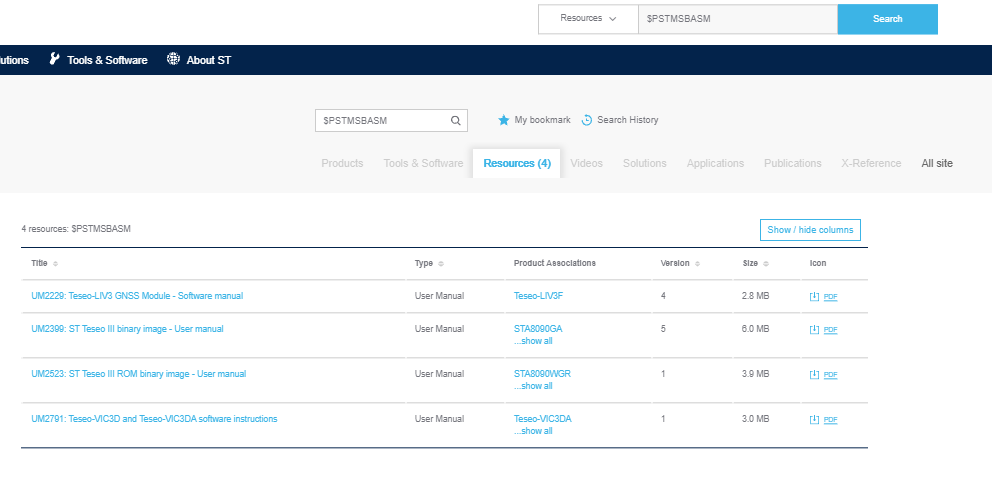

Regarding, AEK-COM-GNSST31. How to access the $PSTMSBASM message for r ionosphere and troposphere correction?
Max VIZZINI
This message is not supported in the TESEO LIV3F module .
Max VIZZINI
These are the User Manuals where there is information about $PSTMSBASM
just type $PSTMSBASM  in the search box of www.st.com
At page 98 on the following manual you will find some description of it for Teseo III chip
https://www.st.com/content/ccc/resource/technical/document/user_manual/group1/26/c2/9b/50/db/3c/4f/e1/DM00495927/files/DM00495927.pdf/jcr:content/translations/en.DM00495927.pdf
 $PSTMSBASM is a message to be sent to SBS engine and there are the following return messages:
  • In case of no errors, the $PSTMSBASMOK message is returned
  • In case of errors, the error message $PSTMSBASMERROR is returned

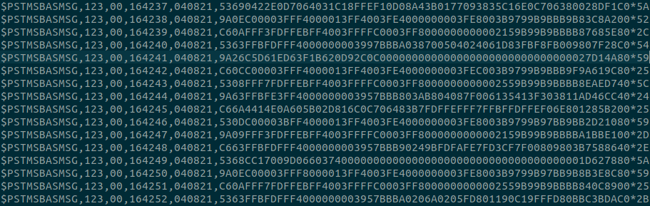

Thank you Max for your fast response.
You are right, I was unable to obtain the $PSTMSBASM message, although I got the $PSTMSBASMSG what is the difference between the two? And I don't find any information about the last, where should I look?

I guess the message $PSTMSBASMSG the sensor sends, has the objective to be delivered to another Teseo, working in mode base station and rover.
So there is no way to decode the SBAS messages? More explicitly, the sbas frame.
I am asking this because I'm working in a thesis about DGPS, I'm using Teseo, and the correction's SBAS was a must, so I really need to understand what I can get from your sensor.
The image represent the information received from the sensor, with the message $PSTMSBASMSG.
