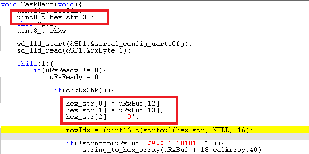

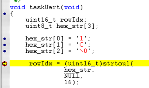

Hi I've declare a 3 byte array uint8_t hex_str[3] and assign a value to convert Hex string to int using strtoul function the point is I set hex_str[2] = 0 but cannot.

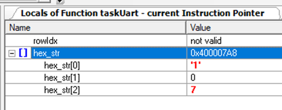

0693W00000bhRz0QAE.pngHere Is my code capture I do breakpoint at line rowIdx = (uint16_t)strtoul(hex_str, NULL, 16);

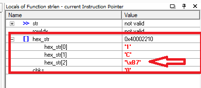

0693W00000bhRqYQAU.pngbut hex_str[2] is not 0 as I just assigned

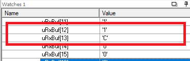

hex_str[0] and hex_str[1] is correct assigned by input array uRxBuf [12] and uRxBuf[13]
That cause strtoul give out a wrong output
please help correct me what I did wrong

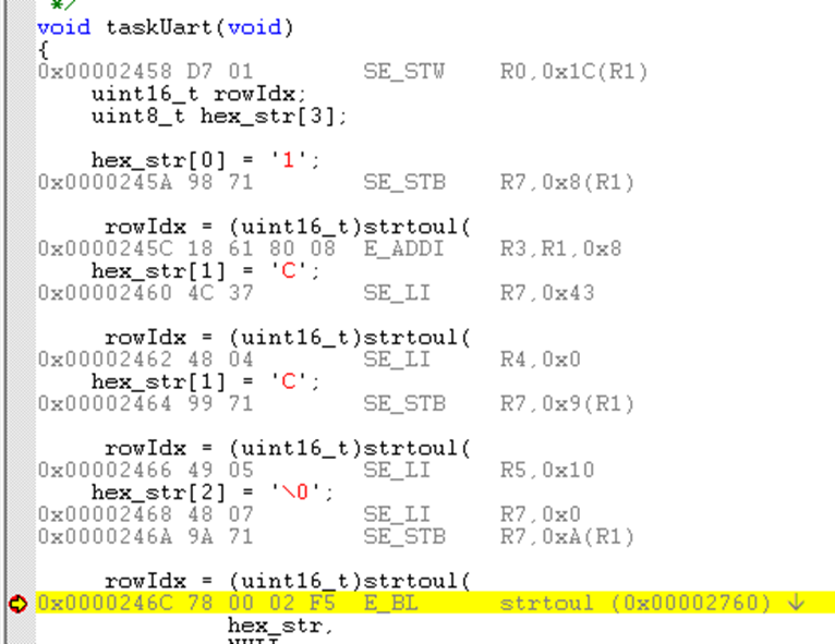

I executed your code on SPC560D
and put a break point in C code on strtoul:
0693W00000bhTqfQAE.pngthen I reproduce the same issue:

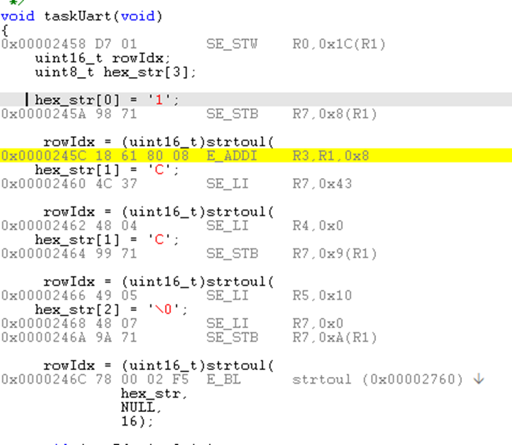

0693W00000bhTvoQAE.pngbut when looking to disassembly:
0693W00000bhTw8QAE.pngI saw the break point is at the beginning of preparation to call strtoul, but before to set the hex_str array
so i moved the breakpoint to the branch to strtoul

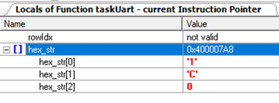

0693W00000bhTwhQAE.pngand then it is OK:
It is a false issue, due to assembly optimization.
setting breakpoint in C code is not optimal
I recommend you to set breakpoint in assembly code, it is safer

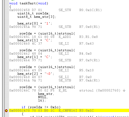

on my side on SPC560D, I put the breakpoint after the return of the strtoul function:
_legacyfs_online_stmicro_images_0693W00000bheYRQAY.pngthen I obtain the good return value (0x1C):
Would you please try to do the same ?

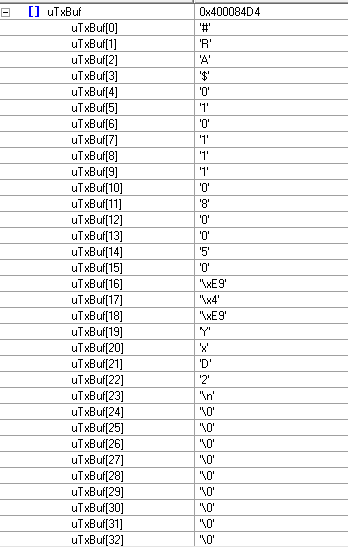

_legacyfs_online_stmicro_images_0693W00000bhesCQAQ.pngAnyhow I manage to fix the issue for strtoul in the top part of function, Don't ask me for a reason why. I'm just play around to try to make it work
now problem is move to lower line with strcat function so the history is I create a cuntion hex_array_to_string by passing pointer of source and destination array. and it not work it return junk to destination array
so I create a loop with sprintf direct to uTxBuf. still got junk

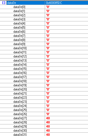

Next I declare another global array dataStr[128] for output of sprintf -- OK I got the correct data
Now I have to concat to uTxBuf using strcat -- Junk
Change to use sprintf with %S -- Junk
and it show junk on debugger and the real data from serial port
this is Hex data
_legacyfs_online_stmicro_images_0693W00000bhesDQAQ.pngdataStr from sprintf -- Correct
Concat to uTxStr -- Junk
