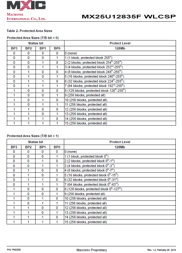

    Hi
    It seems to me the system is not saving the ephemeris data in the flash, due to that with empty ephemeris you'l never get a fix (also if you see good signal levels)
    Which SPI flash are you using?
    Thansk
    Regards
    Francesco

    We are aware that the flash we are using is not in the recommended devices list.
    Our flash device is a 128M part MX25U12835FBBI-10G
    Is these a way to verify or change a configuration to enable it to work?
    It is strange as we are fashing the firmware on it and it is loading.

    Hi
    During the booting from SPI/SQI the application enables also the flash protection to avoid corruption of the binary code.
    Just for test could you try setting CDB-250 = 0x8000000A (do that in the original binary and reflash from zero)
    It's the value required for MX25U1635E / MX25U1635F.
    Let see if it works also for MX25U12835FBBI-10G
    Hope this helps
    Regards
    Francesco

    You advise gave us the clues we needed.
    I actually changed only CDB-250 to 00000015 and now we have a fix. CDB-249 has the default value (enabled).
    Is that a good setting?
    Thank you.
    Dror
    DrorAuthor
    June 27, 2019
    The SPM table for the 128M flash we use looks different than the 32M device.
    See below table from 128M flash device:
