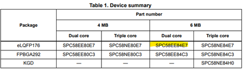

Hi Tassilo,
Analyzing the following datasheet, in which is reported your micro:
I see that SPC58EEx and SPC58NEx belong to the same family.
They have common register map and common base address/bitfield for peripherals.
So it is safe to say that you can use the file named: SPC58NEx_SPC58xGx.svd
(Which you may find in the installation folder)
I'll share the file here.
