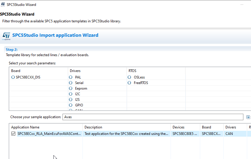

Dear Mr. Siva,
Just import the "SPC58ECxx_RLA_MainEcuForAVASControl - Test Application" application in SPC5Studio with AutoDevKit and you will find in the CAN section the configuration. This demo is conceived to work based on commands of an LCD screen that we have not released yet, but you can try to use a standard one on the market or just remove the control from the LCD. This demo is conceived for AEK-MCU-C4MLIT1 but can be ported on other micros too and it works with the AVAS compact solution AEK-AUD-C1D9031.

SMuru.2
Hello Mr. Max,
Thanks for the update.
We are experimenting with the kit using the sample application- (SPC582Bxx_RLA_AEK_AUD_C1D9031 - Avas Compact - Test Application)
We want to externally communicate with CAN channel for feeding Vehicle Speed and Motor RPM to generate the required sound.
Therefore, we would like to know about the CAN message configuration required (Baud Rate, Identifier, Value Map with respect to Speed and RPM)
Thanks & Regards,
M.Siva
Dear Mr. Siva,
