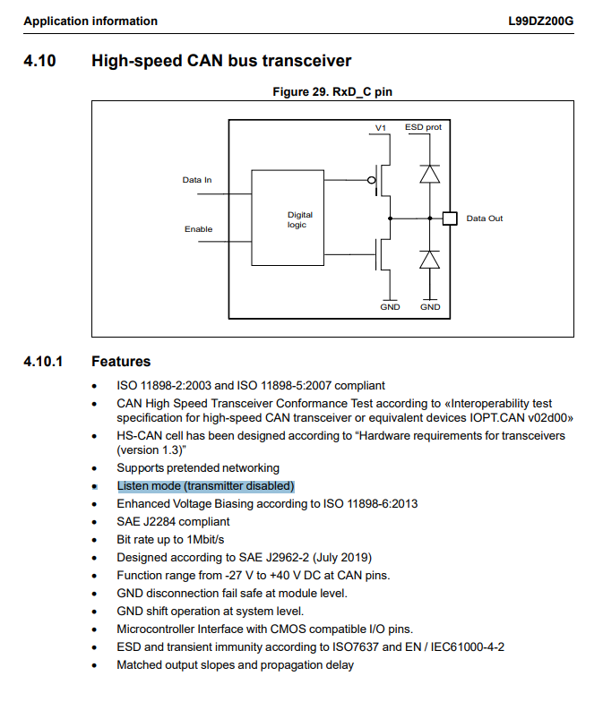

I've recently evaluated the AEK-MOT-MR200G1 and AEK-MOT-TK200G1 evaluation boards to gain a better understanding of using the L99DZ200G device and have noticed that neither of those boards used the on-chip CAN transceiver in the L99DZ200G device but, instead, used a separate CAN transceiver device.
Is there a known problem with using the on-chip CAN transceiver in the L99DZ200G device?
Should I also use a separate CAN transceiver if I'm to use the L99DZ200G in a design?

Hi DLK,
Very acute observation!
The internal CAN transceiver is Listen mode only with the transmitter disabled.
Refer to attached datasheet paragraph 4.10.1.
2023-11-29 10_09_20-Datasheet - L99DZ200G - Automotive front door device with LIN and CAN providing .png
Therefore you need another external CAN transceiver if you want to carry out a standard CAN bus communication, exactly as you have seen the AEK-MOT-TK200G1 and the AEK-MOT-MR200G1.
I guess next question is: why did you put such a CAN transceiver inside the L99DZ200G?
To understand this need, you have to consider the requirements of the Automotive market. The CAN transceiver is used to program the connected microcontroller via a specific bootloader during mass production of the ECU.
It can also be used for OTA (over-the-air) updates of the same microcontroller firmware.
For this reason the CAN transceiver supports the pretended networks and it is able to wake-up the IC based on network activity.
