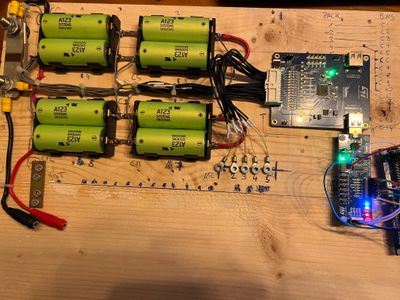

I had a fine working setup with BMS63 for some hours.
Than cell 12 showed 0V and the fault light in the ISO SPI came up.
A short measurement showed, the cell was indeed empty (I am testing with very old cells).
After replacing the cell cell 12 still shows 0V, and the fault light is still on.
If I measure with the testpins on the BMS63EN itself, I can see that there is a cell voltage. So something went wrong with the BMS63EN I think.
Do I need to reset the error/fault? In the manual its stated that software diagnostics need to be run in such case. But..how?
And shouldn´t that be all reset after a complete disconnect and new init?

Hi Michael,
To check for bugs, you should refer to the official platform and use AEK-POW-BMSHOLD.
Then we would have an objective and shared tool that we can compare.
Not having a standard reference is very difficult to understand where the problem is.
I am not sure how you built the battery pack, and I am not sure if you properly connected all the unused sensing pins on L9963E.
If the serial chain of the sensing pins is broken, then the IC will not read the voltages properly.
In addition, in an Automotive system normally cells are pre-charged before being inserted in the battery pack and the charge is equalized with the balancing. Putting a 0V battery is not good, nor cells that maybe are in under-voltage state already.
If you do not want to buy AEK-POW-BMSHOLD, the other suggestion is to request one of our engineering partners for some consultancy support. The Community is not the place for a step-by-step follow-up of your design. If you are interested in the consultant let me know and I will pass you the contacts by email.

Hi again!
Oh thanks- now it works with the readings!
I do thow have one left: it still shows an fault, but I can´t find anything faulty - maybe that has something to do with the cell deactivation?

Hi Michael,
In our main() function example we are calling just few functions dedicated to faults (VCell UV/OV, Fault1, Fault2, etc..). In reality, in page 80 of the L9963E datasheet you find all the possible detected faults.
For each condition in the datasheet, there is a specific function in the driver to plot the result. On top of that there is also a generic function to plot the faults.
You should try to plot each fault to try to find the condition that is generating the fault itself.
Please note that every time you change the code, you need to reset the L9963E to clear previously latched memory conditions (e.g. unplugging and re-plugging the battery pack when trying to mask the GPIO faults).
From your previous screenshot the VBatt Sum is not visible. Did you modify the code?

Yes, I modified the code to print the VbattSum its just called VP. And yes, I unplug the BMS63EN from the pack and even the powersupply to the ISOSPI prior to flashing, also closing UDE prior to restart.
All errors on Page 80 would set a latch, but the Overlatch shows = 0, which got me thinking.
You wrote: "For each condition in the datasheet, there is a specific function in the driver to plot the result. On top of that there is also a generic function to plot the fault" -> I can´t find those in the API list, do you mean the functions in the BMS63EN_diag.c?
I already read the errors that are defined in the diag.c but nothing shows. So I read all registers and printed them over serial. (See below)
Register 3E shows "Balancing open detected" on all odd cells 101010101010000  (21840) - even on cells not active, thats why I think it maybe has something to to with the issue above, deactivation of cells?

Hi Michael,
The value you read on in register 0x45 is correct and it is related to the gpios.
The value you read on register 0x3E is detecting an open in the balancing circuit. The circuit connection both on sensing and balancing is not related to the activation. Despite a cell could be de-activated, the physical electric connection has to be correct or the error will be detected.
The deactivation is something at logical level and not physical level, because the cells remain connected to the circuit.
I would explore the HW more than the SW in this case...
Best Regards,
AutoDevKit Team
I triple checked and even rebuild the complete setup, but I can´t find any HW issue.
I also wonder how I can have a HW error without having a Cell error latched?
I am using the BMS63EN, so I do not see how I could have affected the balancing circuit or how I can solve the issue.
Any hints where to look?

An update:
The condition has worsened. I did not change anything other than letting it run for some time.
Now I got the HWSC terminated (does this mean HWSC failed?) and the VTREF comparator failed BIST.
Its also latched right now, Current measurement is floating around like random readings (no load connected).
Is that internal destruction of the L9963E or is it something external?  The datasheet does not say what this actually means.

Hi Michael,
I apologize but I have no smart suggestion to give to you.
If you fear that the L9963E is destroyed, then the best is to replace the IC or the entire node board, whichever is easier for you.
Other is to remove the batteries verify again your electrical connections, including verifying the batteries are ok.
The only thing I can say is that faults should be eliminated one by one.
Sorry not to be able to help further.
