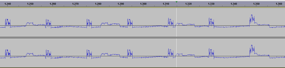

I am using STA321MP to record the audio signal, I have observed the noise from its output signal when there is no speech. The period is ~20ms. Do you have any idea where it is from?2016-01-07 10:23 PM

Thank for the clever suggestion!I do the same and the noise is showed clearly.2016-01-10 10:14 PM

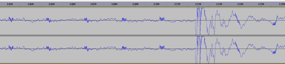

I am using STM32F7-DISCO board to read SDOxx from STA321MP via I2Sx and SPIx channels. The reading data is streamed to codec chipset WM8994 via SAI to play-out the audio signal. The clock for I2S/SPI bus is ~1.025Mhz (16Khz*32bit*2 audio channels).The clock for XTI is supplied from external oscillator 12.288 Mhz. Is the noise caused by my current circuit? I see It correlates with power line signal(50hz)I am building my own board, I hope that kind of noise will not occur.2016-01-11 5:21 PM
Hi Phan,
it doesn't look like 50 hz noise from AC power supply , but some digital noise , like pop corn. according to your discription, the MCLK for STA321MP had been provided from external clock source and freq is 12.288Mhz , did you also use this osc for STM32 ? due to STA321MP was a slave device, the I2S clock ( LRCK and BICK) should be provided from STM32 ( as master ), if MCLK was not synchronized with I2S clock , it will lead to pop corn noise in audio band . Thanks , YT2016-01-11 8:09 PM
Thank for the comments! I got your point.
STM32 is using 25Mhz osc. They are not the same clock now. I tried to provide MCLK to STA321MP from STM32 last time. But for some reasons, it didn't work last time. Now, I will revert to that option and check but I don't think it is the root cause. Since when I removed Microphones or set MUTE for STA321MP's output, I get same noise signal. As far as my understanding, all audio signal is 0 would work without noise even the clock is not synchronize. Please correct if I am wrong.
