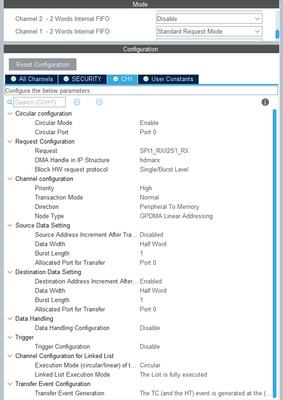

I also want to receive the data continuously in circular mode via DMA (or GPDMA in the case of this MCU).
Reading other sources, I've concluded that the following setup should be established:

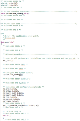

The audio DMA functions can be seen below. The Audio_Init() function is called once in the main function, and the CpltCallback functions are called by DMA interrupts.
static uint16_t audio_rx[AUDIO_BUFFER_SIZE];
static uint16_t audio_tx[AUDIO_BUFFER_SIZE];
void Audio_Init(){
	audio_ready_flag = AUDIO_DATA_FREE;
	if(HAL_SAI_Receive_DMA(&AUDIO_RX_PORT, (uint8_t *)audio_rx, AUDIO_BUFFER_SIZE) != HAL_OK){
		Error_Handler();
	if(HAL_SAI_Transmit_DMA(&AUDIO_TX_PORT, (uint8_t *)audio_tx, AUDIO_BUFFER_SIZE) != HAL_OK){
		Error_Handler();
void HAL_SAI_RxHalfCpltCallback(SAI_HandleTypeDef *hi2s){
	audio_ready_flag = AUDIO_DATA_READY_HALF;
void HAL_SAI_RxCpltCallback(SAI_HandleTypeDef *hi2s){
	audio_ready_flag = AUDIO_DATA_READY_FULL;
(I'm omitting all the HAL stuff, since I've already showed the setup in the above images. I want to note that all of the HAL code seems to be configured correctly --> no errors or warnings)

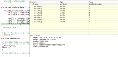

When my hardware has no audio source connected to it, I would assume that the audio data stored via DMA in the audio_rx buffer should be equal to 0 (and maybe some weak noise).
However, my buffer is filled with what appears to be 16-bit garbage values:
Why is this? I've successfully implemented this code on my old build, which used a STM32G4.

Best answer by LCE
You are lucky, your SAI and your ADC are working correctly.
Now your 32bit buffer shows perfect noise values around 0, with about 100 dB SNR, the least 15 to 16 bits noisy only.
Check the 2's complement data format: https://en.wikipedia.org/wiki/Two%27s_complement
Your ADC ist just noisy around 0, example for 2's complement:
8 bit 2'sc:
1111 1111 = -1 !
0000 0000 = 0
0111 1111 = +127
1000 000 = -127
When working with audio formats, you should have heard about that. ;)
If not, now you know... :D
So it was mostly a 16 / 32 bit problem.

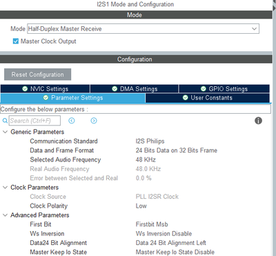

Hello, I have a similar problem with my nucleo H503RB. I'm trying to make it work with Pmod I2S2 module (ADC+DAC). For now I've connected only ADC via I2S1. This is my HW configuration:
I2S config:
GPDMA config:
Code:
Output:

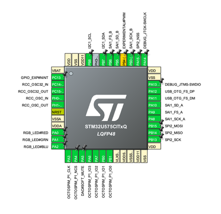

Below is the pinout on my STM32U575, if that is of any help:

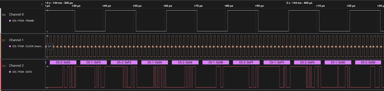

I've excluded the DAC for the time being, trying to evaluate only the ADC.
1. The GPIOs are correct according to the datasheet.
2. Here's what I'm getting on the scope. Every frame is transferred in 8 bits, which kind of makes sense when you look at the way pData is setup in this function:
HAL_StatusTypeDef HAL_SAI_Receive_DMA(SAI_HandleTypeDef *hsai, uint8_t *pData, uint16_t Size)
Could it be that I'm messing up here?
#define AUDIO_BUFFER_SIZE 64
uint32_t audio_rx[AUDIO_BUFFER_SIZE];
#define AUDIO_RX_PORT hsai_BlockA1 //hsai_BlockA1 pre-defined by HAL
//initializing call of the SAI receive via DMA function
HAL_SAI_Receive_DMA(&AUDIO_RX_PORT, (uint8_t *)audio_rx, AUDIO_BUFFER_SIZE);
3. Tried pulling down the data line, but still the same result as above. I'm ruling out tristate, since the data line seems to be driven high.
4. I've used this ADC with an STM32G4 MCU, where I used a simple I2S interface without needing a master clock. On this device, everything worked perfectly.

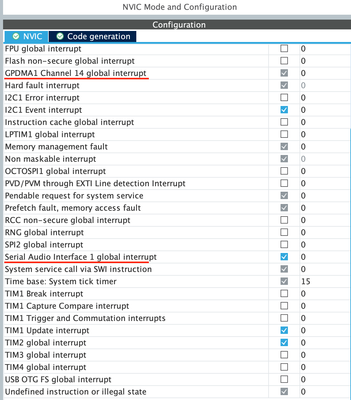

5. Here's the NVIC, where the ISRs are enabled both for the SAI1, and for the GPDMA channel it's using.
6. The RX data changes randomly and constantly.

SCLK should be 4 times higher for 2 x 32 clock cycles within 1 LRCK cycle, but you actually seem to set it up correctly with SAI_PROTOCOL_DATASIZE_32BIT.
I would read the SAI registers where all the clock settings are done. Maybe there's a HAL bug?
Are there any SAI examples from ST for that U575? I would compare DMA and SAI setup.
And check if your ADC really runs as SAI_I2S_STANDARD, not as left justified (as most audio ADCs that I have used).
February 24, 2024
Unfortunately, it seems like the Cortex-M33 is somewhat of a black sheep when it comes to documentation. If ever I find some material on GPDMA + SAI implementations, they're usually very muddy or unspecific. I will take another look around the web and let you know if I find anything useful.
I just found that the scope showed such strange readouts because the sampling frequency was too low...
Heres the full resolution scope when I increased the sampling frequency from 4MS/s to 16MS/s:

Now things look much better on the scope!
The "noise" you see is perfectly okay for this ADC, there's nothing happening on the data line for the first 16 bit or so, so you're in the range of ~ 100 dB SNR, like the ADC is specified.
This might hint that your noisy ADC buffer data somehow shows only the noisy 16 LSB.
By the way, your DMA setup looks like WORD / 32bit, but your ADC buffers are 16 bit... so better change the ADC buffers to 32 bit, at least for testing.
LCE
Principal II
February 26, 2024
Okay, so the CubeMX pictures say that DMA is configured as half-word.
SAI is configured for 32 bits = word.
Your code snippets show for DMA:
 NodeConfig.Init.SrcDataWidth = DMA_SRC_DATAWIDTH_WORD;
 NodeConfig.Init.DestDataWidth = DMA_DEST_DATAWIDTH_WORD;
I don't know the internals of the GPDMA, but it looks strange to me.
I would really start by setting all to WORD / 23bit: SAI/I2S, buffers, DMA.
